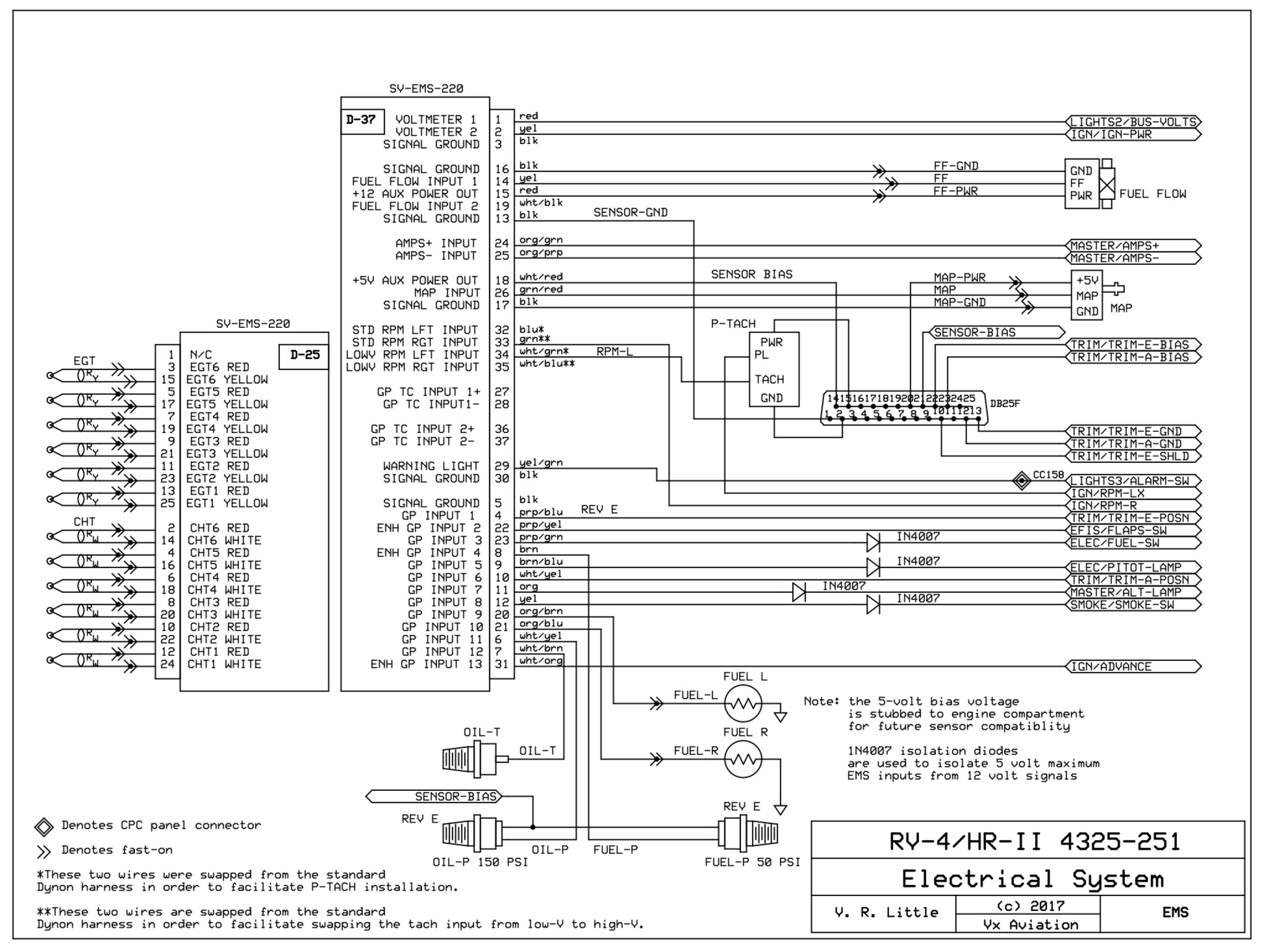

The EMS is not happy with signals that exceed 5V. Here is what I did.

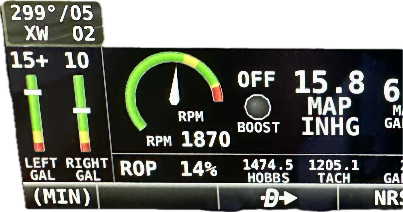

I use to have a small LED on the panel that would illuminate when my boost pump was on. It was on the periphery of my vision and was frequently ignored. When I upgraded my system to Skyview HDX I created a digital indicator and placed it directly beside my RPM gauge. Now it’s always in my primary line of vision and is difficult to ignore. Well worth the effort.

Check put this post on sensing switched inputs:
A more refined diagram is here: EMS Wiring
