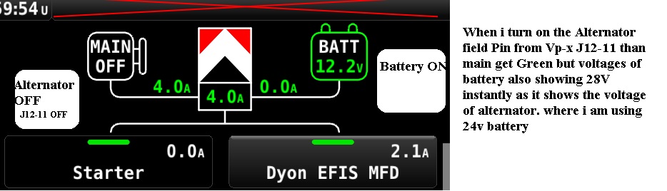

I am preparing a Lab demonstration. where I am using a 24Vdc battery as Aircraft battery input and. 28Vdc Power supply as a dummy for Alternator representation.
I am using PPS with Vp-X Pro
from PPS I am using Pins
Alt EN Pin 8
Batt En Pin 1
Master Pin 7
Fault indication Pin 13,14
Starter Switch INput pin 3

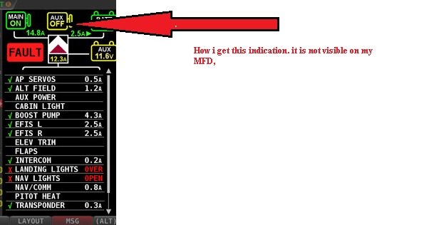

also VP-x Pin
J12-11 Alternator Prime Pin
J10-1 for starter
J2-11 for starter
Problem is that when I switch from battery to Alternator. there is no special indication of the alternator. if I assume the main bus indication is an indication of the alternator. than why voltage of the battery show voltages of the alternator. Why it is not showing Aux or alternator voltage separately.
