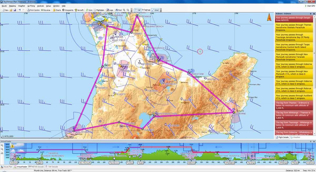

In the UK we have some fascinating airspace, for example around heathrow. For VFR routings we often have to dive under 1500 zones, then back up to under 2500, then higher.
It would be great for these uncontrolled complex routings to have the AP automatically follow defined altitudes.
SkyDemon software has a fantastic feature for the planning and flying of these - see picture, it's the lower panel. You can drag sectors between waypoints up and down to different altitudes, thereby avoiding controlled airspace. It automatically does the climb/descend angle based on a simple standard parameter of Feet/Min. So it looks like a "connect the dots" logical move for Skydemon to WIFI this to the Skyview and then AP to fly it automatically :)
Apparently several of the big certified EFIS systems CAN do this - G3000 can, and from another forum apparently the Advanced AFS 5600 can do it too?
