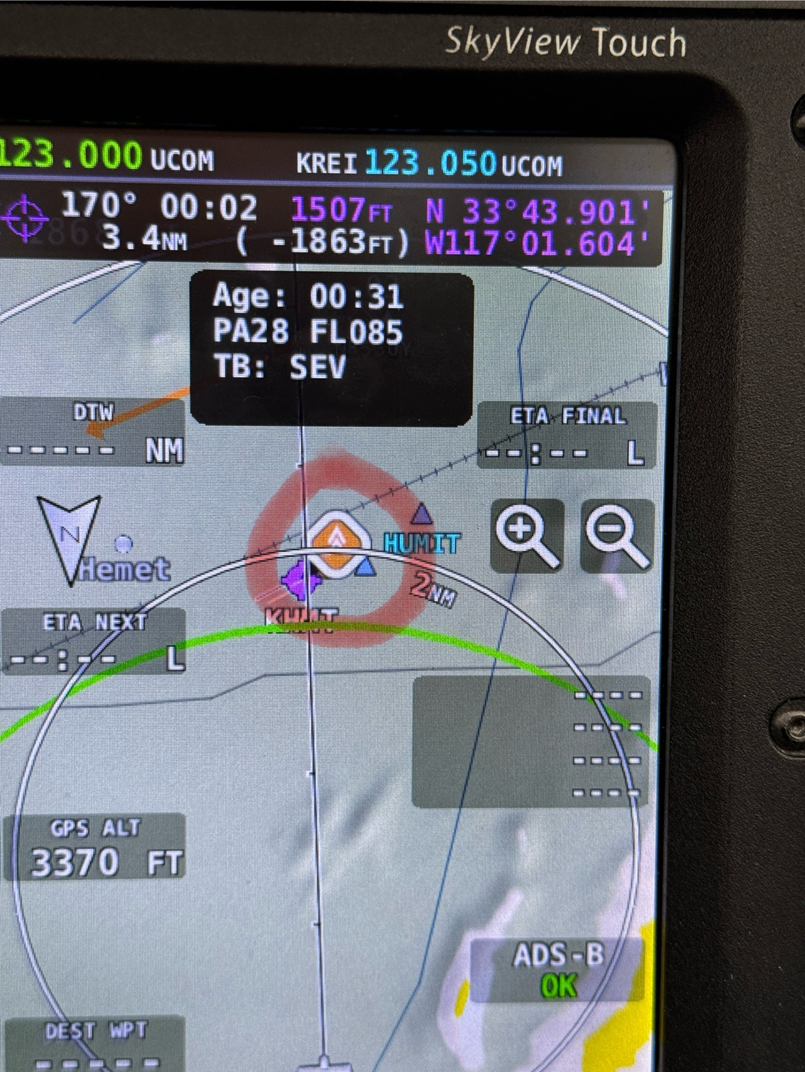

What is this symbol?
Seagull
Nov 3, 2020
38
Five years flying behind the Skyview and this is the first time I have seen this, (circled)? Anyone seen this before? When I touched it the information popped up above it

Page 5-77 in the current Skyview user guide (Rev P).

Search in whatever Skyview User Guide suits your system for a paragraph titled "PIREPS"
Also search for a paragraph "Weather Options Controls" for how PIREP notifications are toggled on/off on the map page.

Thank you all. Always something to learn. I have 1200 hours with this same plane / Dynon, never saw these, good to know, a bit embarrassed.

It's worth reading the changelogs for each new software version. New features such as this (this has been available for a while) are noted in the logs and described in the updated User's Guides/Installation Manuals.
