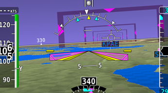

As stated above, HITS = highway in the sky. It projects a series of boxes on your screen to fly thru as a method of course guidance. Mostly regarded as toy or crutch by highly experienced or professional aviators. I suspect it is included as a selling point to sway the, ummm, 'less experienced' as kewl.
Highway In The Sky. Little rectangles showing the way.
I've seen that on MS Flight Simulator, never in a Boeing cockpit and didn't know Dynon could generate it. I suppose it could be used for instrument training but probably not a good sign if someone needs that to maintain SA.
Highway In The Sky (HITS) on Synthetic Vision
In software version 15.0 or later, when a Flight Plan is engaged, either with, or without Autopilot, Highway In The Sky (HITS) indicators (rectangles) can optionally be displayed in Synthetic Vision of the PFD. HITS is most useful for “hand steering” a Flight Plan when Autopilot is not installed or not engaged.
HITS will show the (VFR-oriented) Vertical Guidance that SkyView generates. All other altitude guidance is at the altitude bug, even when an external flight plan is being shown. HITS is intended to be used for enroute flight and during SkyView-generated Vertical Guidance.
Display of HITS can be toggled on and off: PFD > MODE > HITS. Repeated presses of the HITS button toggles display of HITS on and off. Note that SYNVIS must be enabled, and an altitude bug set, to display HITS
