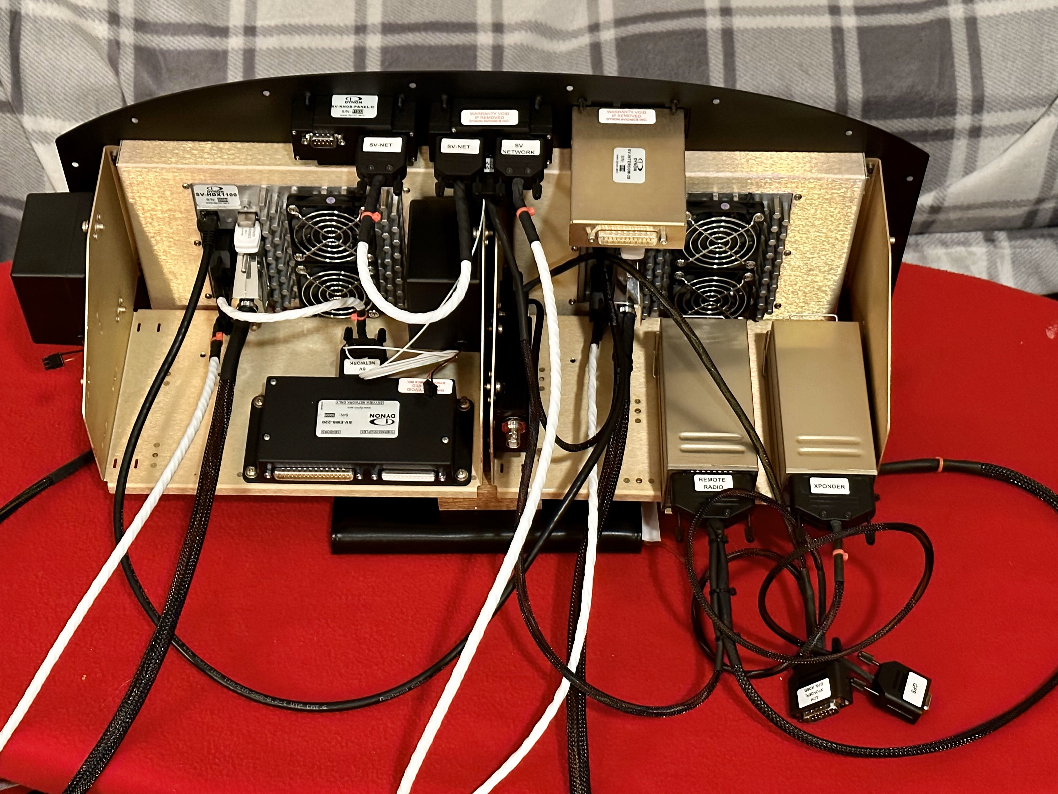

The RV-8 is one of the few aircraft that can take advantage of the Dynon Fast Track mounting system. There is plenty of non-obstructed space between the rear of the SV-HDX screen and the front baggage bulkhead. That is not true for other RV models. I used two Fastrack trays to mount two back up batteries, Transceiver, Transponder, EMS module and the SV-ADSB module. See picture below. Note that the backup battery in the picture was moved to the interior of the Fast Track tray prior to installation.

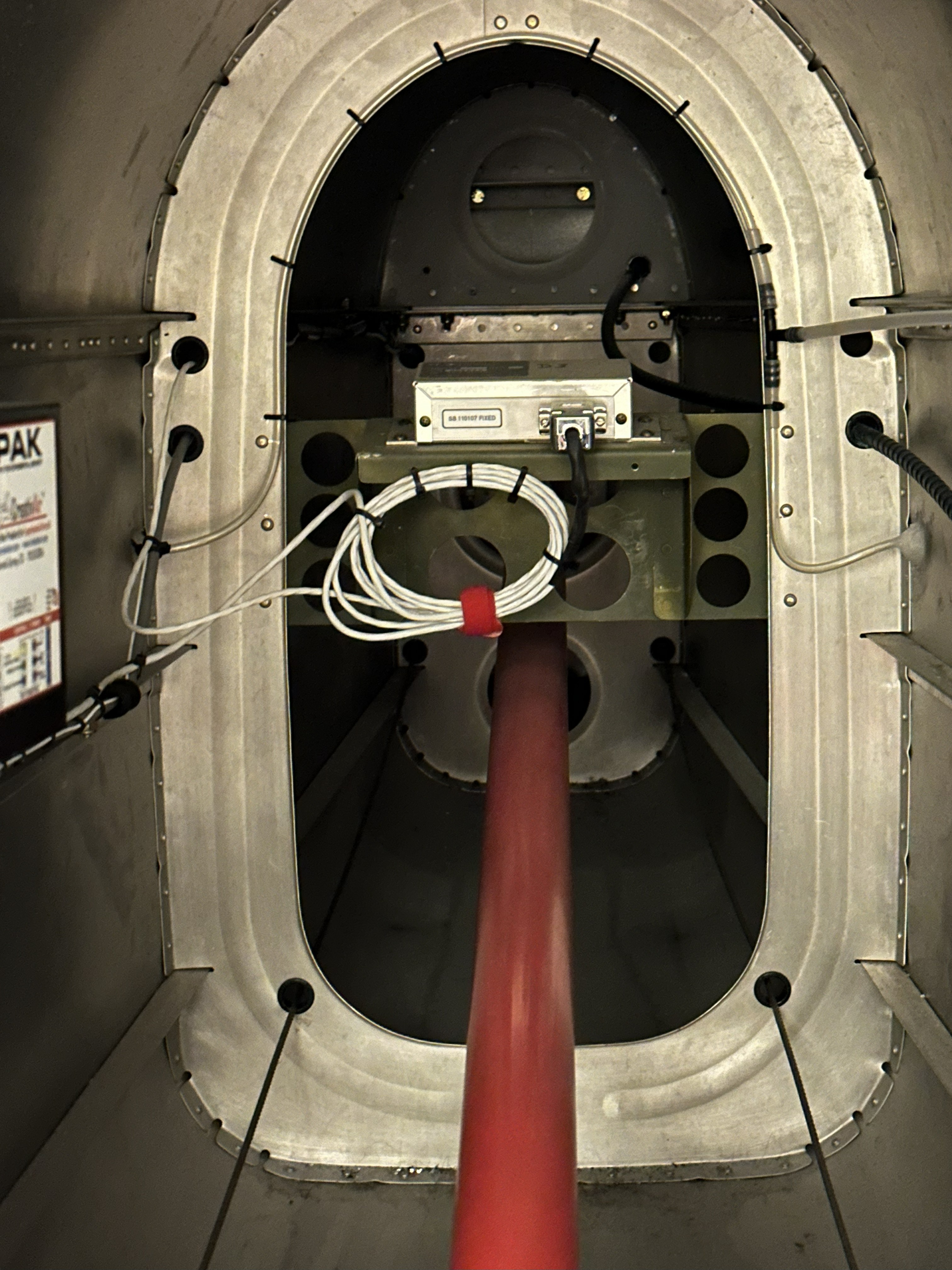

You can mount the SV-MAG-236 in the wing tip. Keep in mind that your OAT probe is connected to the SV-MAG-236.
The majority of RV-8 builders install the magnetometer in the aft section of the fuselage. You will need to fabricate a small shelf that spans the rear bulkhead where the static lines are installed. For the HDX magnetometer I fabricated an adjustable shelve so I could zero out the pitch during install.
The OAT probe was installed under the right horizontal stabilizer. This keeps it out of the sun, away from the exhaust and prop slipstream
and simplifies magnetometer connection.

Good luck with your project
