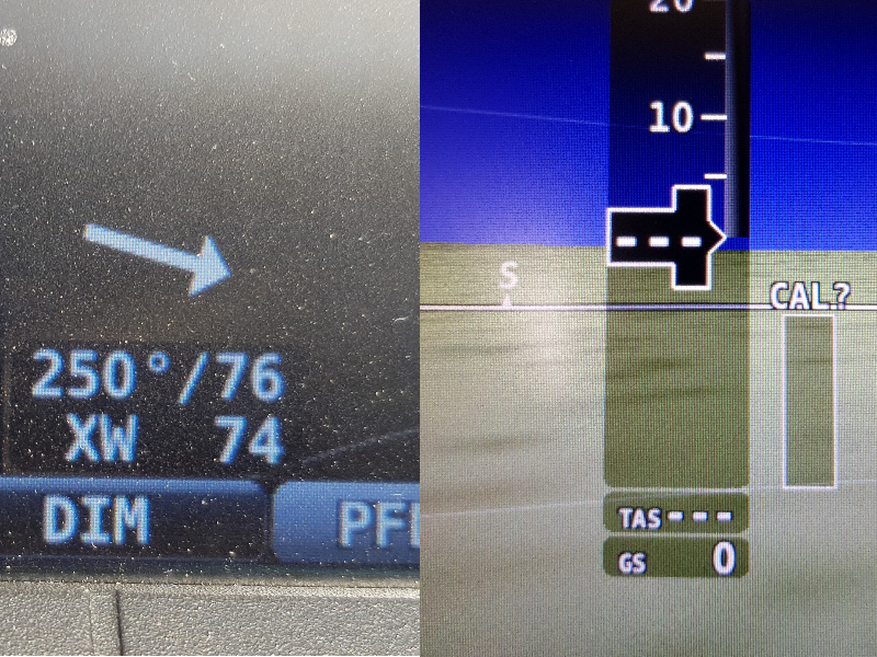

I am just started flying my aircraft and found several issues with Skyview system.
One is AoA not calibrated, as seen on the pictures.
Other is the WIND VECTOR set in the wrong units (Knots) or missfunctioning and in consequence drfting the FLIGHT PATH VECTOR well away of the real trajectory.
How could I solve those problems?
Thank you
Both of these require in-flight calibration, which the installation manual describes. Your winds are wrong because your heading is wrong and your compass needs calibration.
Generally, these are both things we would expect the aircraft manufacturer to complete before delivering an aircraft.
