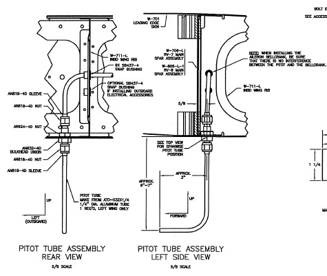

The likly source of the partial blockage is condensation, combined with my aircraft being a tail wheel.
The tail down stance of the airframe, means that the pitot system is tilted up, while on the ground. It would only take a small amount of condensed water to collect in the inevitable bend (found in most if not all underwing pitot systems) causing a partial/total blockage.
Someone correct me if I'm wrong, but isn't *every* taildragger's pitot tilted up while on the ground?
Why haven't the thousands of other tailwheel planes with Dynon equipment suffered the same problems as our OP?
Because Dynon, and other properly designed pitot tubes have drain holes specifically for this reason.
That's true, but then again, I didn't build one that used the roll-your-own pitot tube that Van's called out in their plans, at least the earlier models. Did those plans include adding a drain hole to the bent aluminum tube? I honestly don't know the answer here.
But...I suspect they did not, which would mean the question still stands. How come all of those planes flying around with aluminum tubing pitot tubes don't report the same problems as the OP?
ETA: See attached, straight from the plans (RV-7A in this case)
