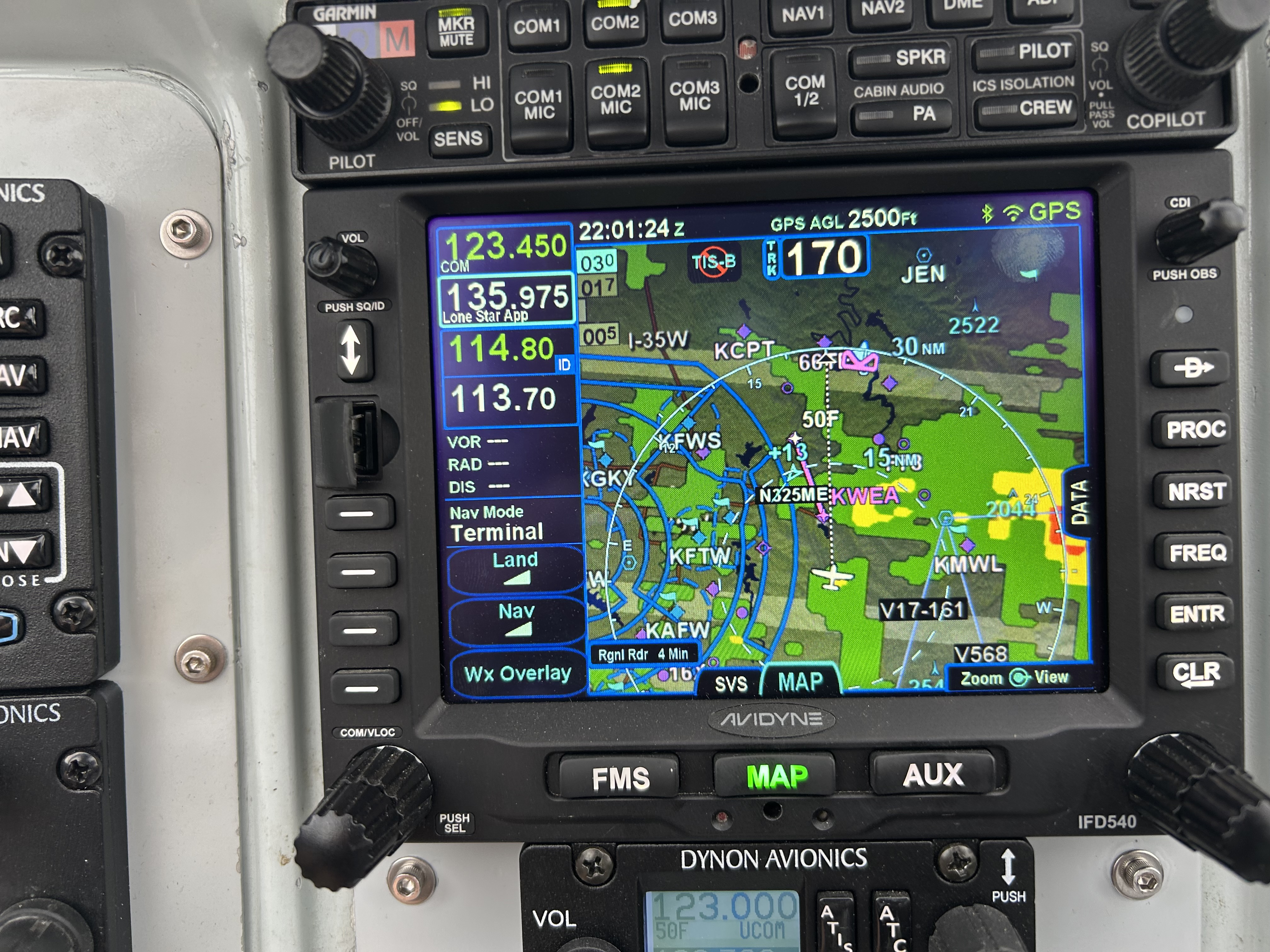

I flew with bspatz fixGDL today and was able to get the skyview ADSB data to display on the IFD.
Thank you Bradley!

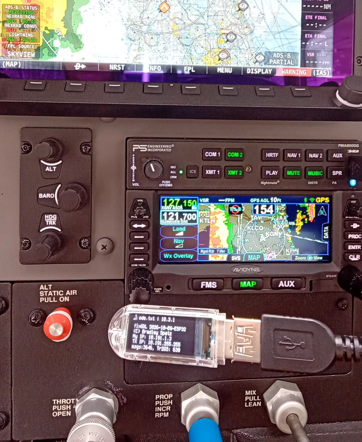

Update: fixGDL now works on microcontroller USB dongles, standalone units dedicated to this task that can stay in the airplane. fixGDL enables multiple ADS-B-In/GDL90 clients to use/depict weather/traffic, e.g. EFBs or as a good test case, the IFD series MFD/navigators, as shown below:
These inexpensive devices ($5-$12, ESP32 series) are quite capable with CPU, storage, WiFi, and some have small displays. Otherwise fixGDL uses LED colors to convey status (WiFi acquisition, packet reception, errors). A small web server also provides status.
I've tested with the IFD and several EFBs that expect standards compliant GDL90 (fltplan Go, Avare, AvareX, etc.) and which otherwise don't work with the Dynon. I've flight tested over several hours, with additional testing ongoing (thanks kurtfly), but these seem solid and much more convenient than an Apple/Android app.
