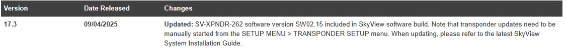

The update is only for 262 transponder correct? Not sure if scrollF4 has 261 (US) or 262 (outside US)

Thank you, I was going by the update and it only shows -262. I wasn't going to update to 17.3 since nothing applied to my configuration, now I will.
