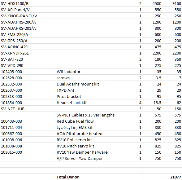

Geez someone got out the wrong side of the bed.
I need educating all right, I need to know how I can sell a USD$21K package to my clients for $30K. Because that is some clever trick.
By the way for the $21K below that has a Yaw Damper included. It could have a GPS 2020 if not being mated to a TSO146 GPS, and it could have ADSB in and still be less than $22K. And be far more feature rich than a G5 and an EDM. Talk about a Prius vs a Tundra for going off road......
But what the hell would I know. Only a newbie at this Dynon stuff since 2004.
I suggest you actually buy Garmin, I really do.
Hrm... See attached, plus an estimated 8-10k install price... that's 38-40k according to math 33-35k if only 1 screen. But hey, Why dont you give me your phone number and I will order through you, since I am wasting my time with the worksheet DYNON provides on their website.
PS: Imagine being so disgusted with someone else's choices / opinion that you dont even want them to get the same thing as you because that would somehow degrade your own lot. Sad.

This was originally about one thing...Dynon support for legacy AP servos, versus having to buy/install new Dynon servos. All the other costs and spreadsheet data is irrelevant, at least to this discussion.
You are being quoted 10K or something like that to have new servos installed by the A&P. The cost of the servos *themselves* is only around 1700. So your beef really is with the cost of modifying a certificated aircraft, not with anyone here. We're simply pointing out that your suggestions to Dynon (to add support to their products for AP servos they neither make nor sell, while diverting engineering, sales and tech support resources to such an endeavour) probably doesn't make sense for them. If you can't accept the lack of Dynon support for older electronics by other companies, then it seems you have a couple of choices: buy everything else from Dynon and go without the AP, buy everything from someone else who does support the servos you have, or some hybrid combination such as was mentioned before.
Aviation is not a cheap hobby, and from your spreadsheets, you're doing a full-up, complete panel overhaul. That's not going to be cheap on your non-EAB aircraft, no matter who you go with. Perhaps you should just factor in the cost of the installation of the new servos, suck it up and live with the impacts of owning a certificated plane.
