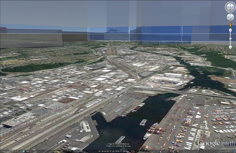

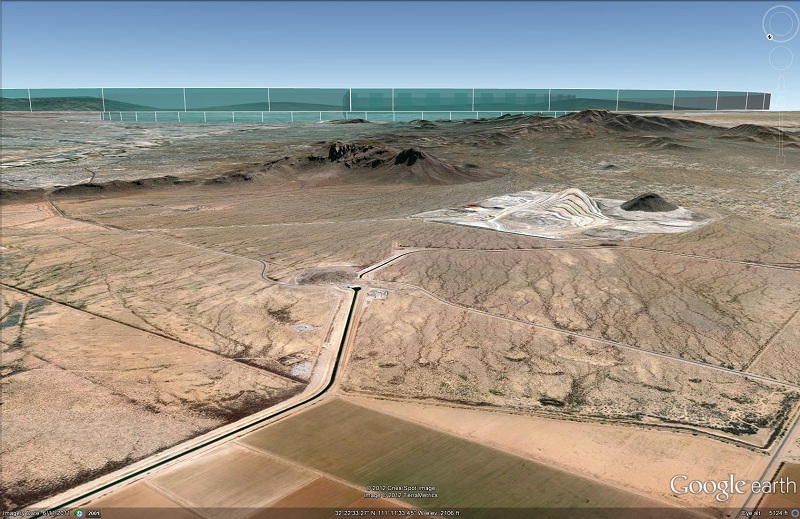

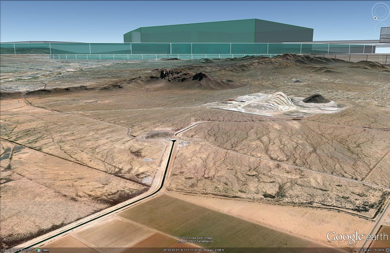

Here's a few images to show what airspaces really look like when they're scaled like real airspaces:
1) KTUS, 35 miles away from the airport, only KTUS airspace, 3000' AGL
2) KTUS with all other airspaces turned on (not Class E or A), 3000' AGL. Note the now looming airspace above is actually about 50 miles behind KTUS.
3) Approach to KBFI from 2 miles away from runway
