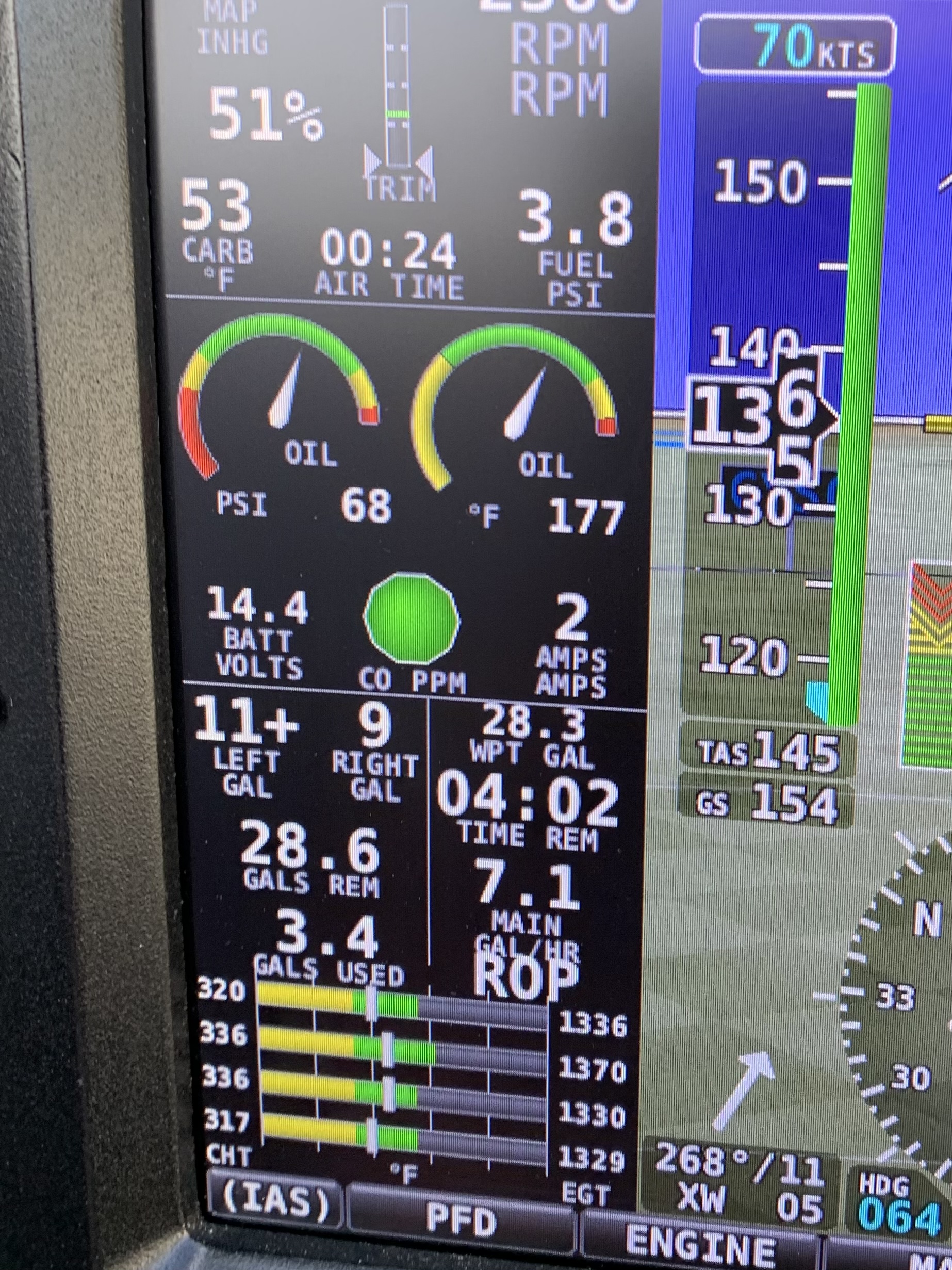

I installed mine last year and didn’t need any “secret file” from Dynon. Just followed the Dynon SV specific instructions from the Aithre website and downloaded the widget from their site. Set it up as a pressure sensor and that’s it. The last SV update cleared the widget but I just put it back.
This is an awesome pic. Love the digital DOT.
