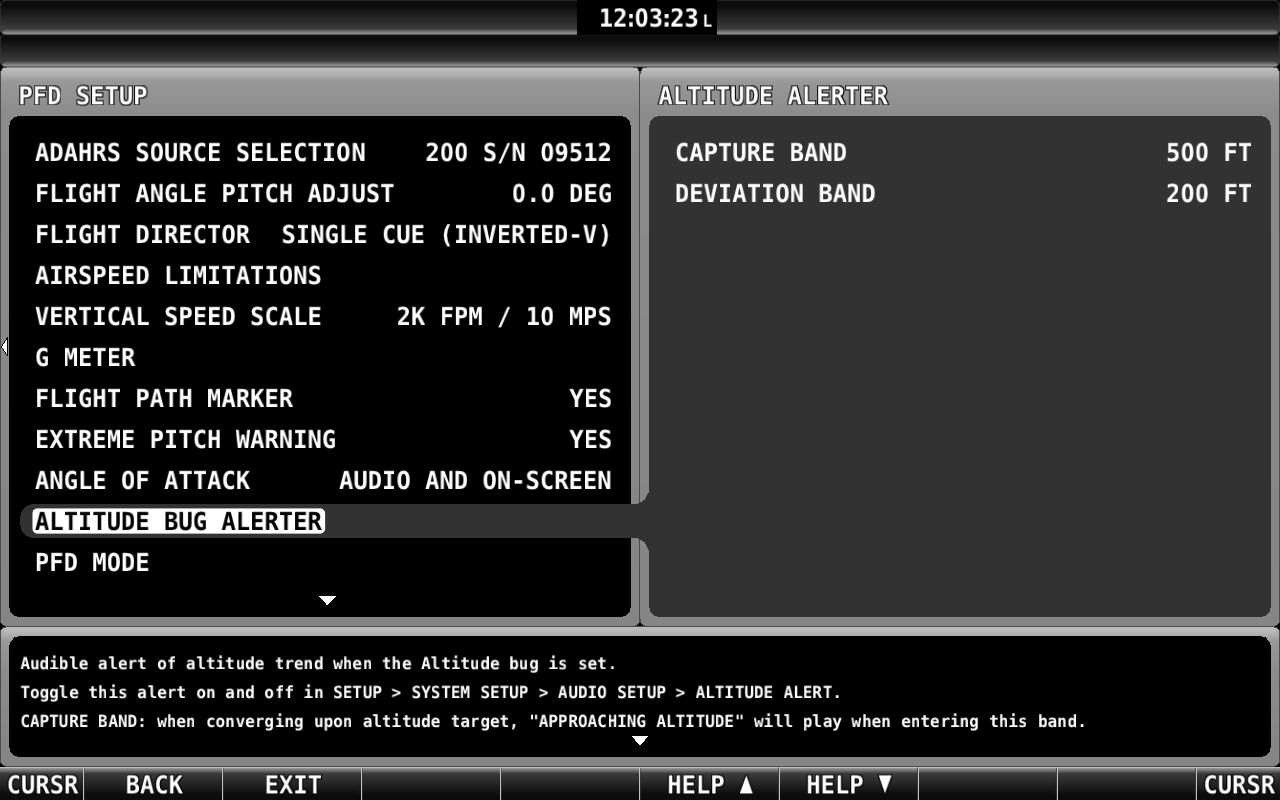

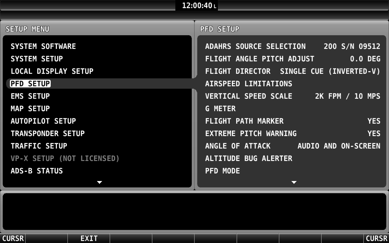

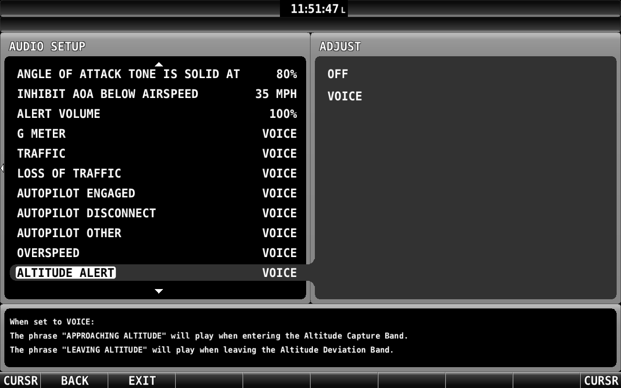

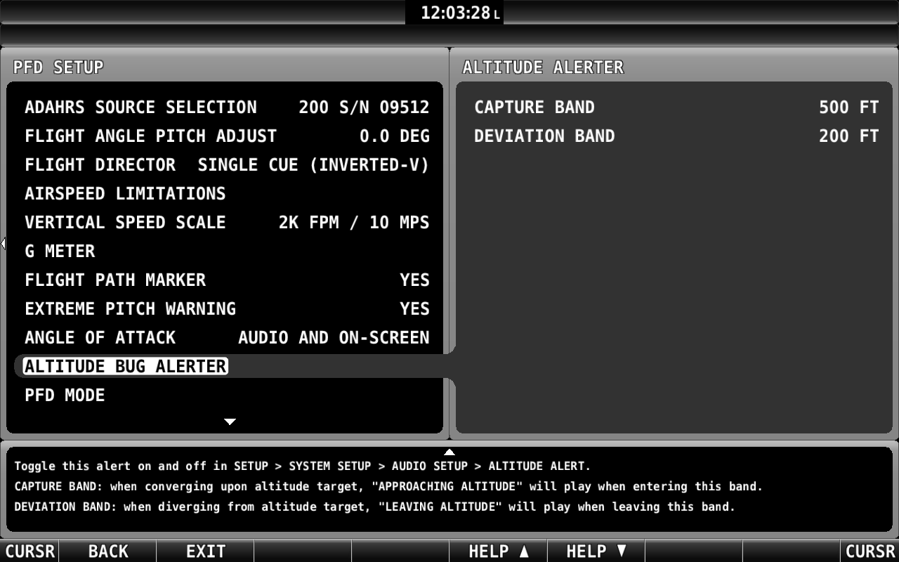

Not sure about the SE but attached are screen shots taken from the HDX PFD>SETUP MENU>ALTITUDE BUG ALERTER menus with instructions for operations on the bottom. It appears the audio warning message can be disabled in the SYSTEM SETUP>AUDIO SETUP>ALTITUDE ALERT menu (last menu picture).

Thanks for your help. I have looked in those onscreen locations several times but the words ALTITUDE BUG ALERTER are just not there! I have been back to it to check that I have scrolled down. I have also tried it in flight with the bug set, but it still does not appear.

OK. I have checked again. There is definitely no option of ALTITUDE BUG ALERTER in the pdf setup.
In the system setup/audio setup there is ALTITUDE ALERT but this only switches it on or off.
