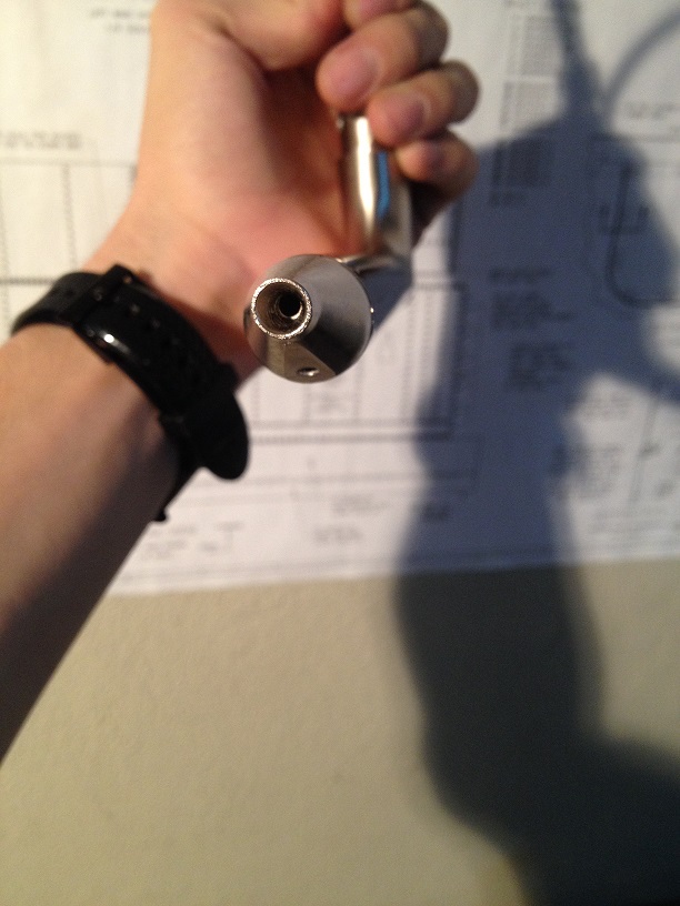

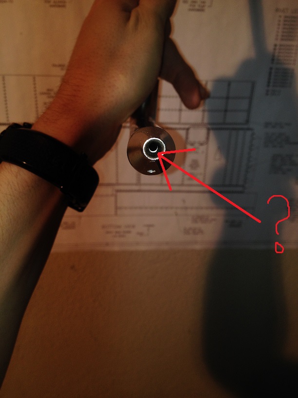

Hello,
New to the forums and I have a question regarding my Dynon heated Pitot/AOA probe.
It caught my attention that the stagnation port (opening facing the wind) is not completely open (or otherwise round) all the way through the pressure hole or tube.
It raised my concern because it can somehow restrict the flow of air coming in from the outside, thus having different readings at different attitudes.
I was wondering if this is normal due to the integration of an AOA in the system, or it is a faulty (misaligned) unit?
The unit has always been in the box since shipping, so no damage (i.e. fall) has occurred.
Thanks

That is normal and does not affect the accuracy of the reading.
