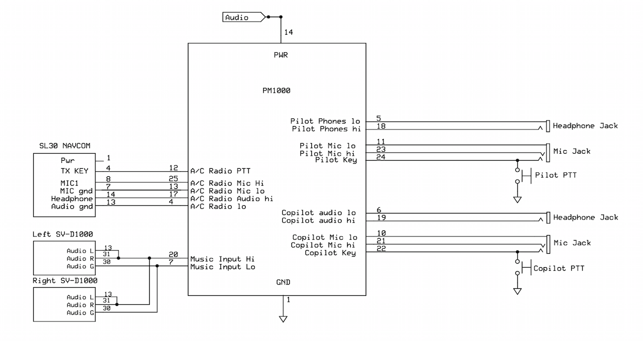

I used to have a PM1000II before I upgraded to the Dynon Intercom when I added a second radio. You connect only your radio to the A/C Radio pins. Connect your Skyview audio to the Music Input pins 20 & 7. (page 8 of PS Manual).
Extract of my aircraft old schematic attached.

I was thinking that was an option. It will still work with music as well right?

Dynon recommends 50 ohm resistors to ground on the SkyView audio outputs.  They serve to drop the audio level and system noise.
You may find that a lower value resistor works better.  Only one per SkyView is required in this application.  You should be running the SkyView audio level around 75% or so to minimize noise.
