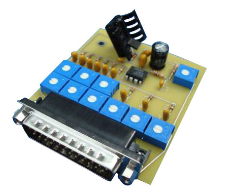

You could also use a small audio mixer to combine your radio, Dynon audio and any other audio device (music player?) - such as this:
If you need a mixer that allows you to adjust and balance all incoming audio levels, they also carry this:
