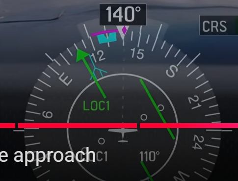

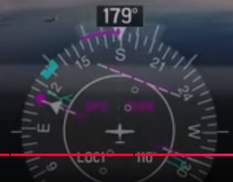

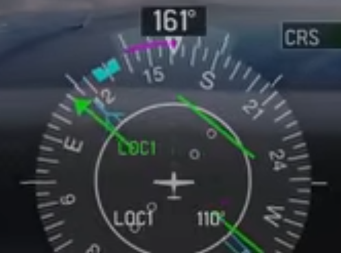

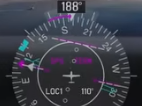

My question stems from the following you tube video:
In this video, during the intercept of the LOC signal, just before the LOC needle comes of the wall (around 22:20 into the video), there are two CDIs displayed, a solid line magenta one being driven by the GPS signal, based on the published ILS final approach course, and a white, dashed line one representing the actual LOC signal, (which has not come off the wall yet).
When the LOC signal comes off he wall, the LOC CDI automatically changes to the following display, with a solid green line CDI .
Is this possible in Skyview? Clearly, the data from the GPS is always available, and if the NAV/COM receiver is tuned to the appropriate frequency, The LOC navigational signal is also available. I am guessing that at the moment, the current software release of Skyview only has one available CDI object that can be bound to a data source, and that it can only be bound to one data source at a time. To do what the G1000 seems to be doing, it would have to be coded so that the one single CDI object in code had access to both the GPS and the LOC (SL30 compatible) data sources, and could display both, in different colors, or,
Skyview would have to be modified to have two CDIs (like it now has two Bearing pointers) and the when a LOC/ILS approach was loaded, it would have to initially display both of them, a magenta one bound to the GPS IFR Navigator, and a white dashed line CDI bound to the LOC signal.
Then, when the plane gets close enough to the LOC final approach course for the CDI to come "off the wall", the GPS CDI would disappear and the LOC CDI would change to a solid green line...
Would an upgrade to implement something like this require a hardware change, or just a software upgrade?
