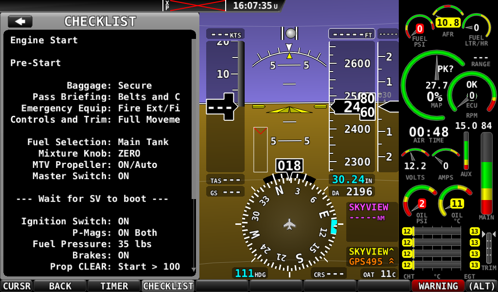

After a few attempts: Voilà
The trick was to add the '|' character to the start of the line. It seems to be a non printing character but holds a place so that the spaces aren't ignored. I didn't try any other characters.

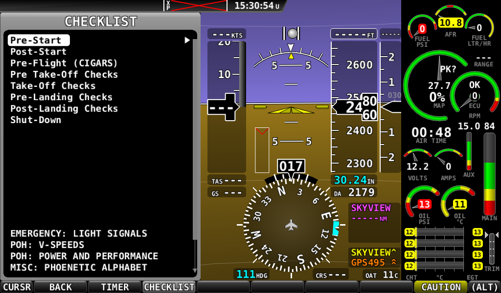

Everyone probably found this second trick. To add blank lines to the checklist titles, leave a gap in the numbering. I deleted a number of titles and ended up with blank lines. Hmm. More formatting ideas. A blank line would nicely separate takeoff from landing checklists.

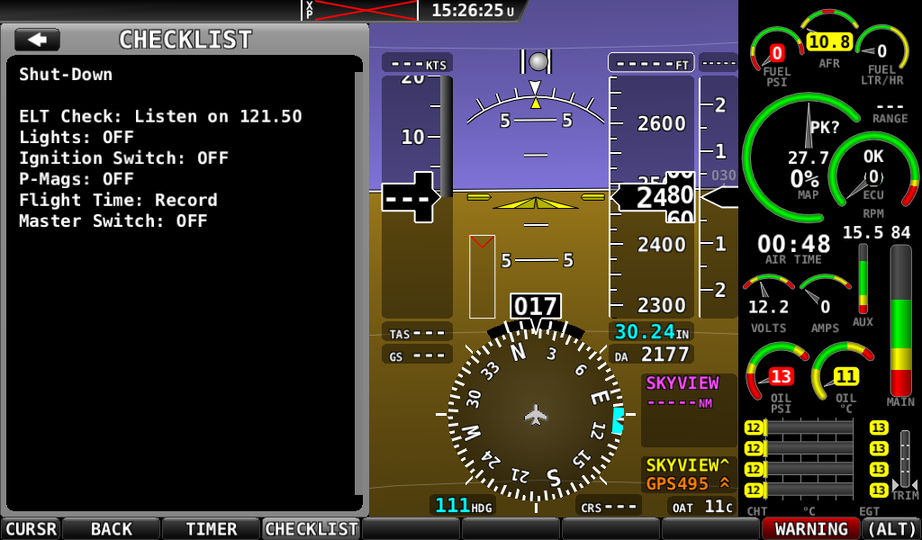

CHKLST7.TITLE, Shut-Down
CHKLST7.LINE1,
CHKLST7.LINE2,        ELT Check: Listen on 121.50
CHKLST7.LINE3,           Lights: OFF
CHKLST7.LINE4,  Ignition Switch: OFF
CHKLST7.LINE5,           P-Mags: OFF
CHKLST7.LINE6,      Flight Time: Record
CHKLST7.LINE7,    Master Switch: OFF
