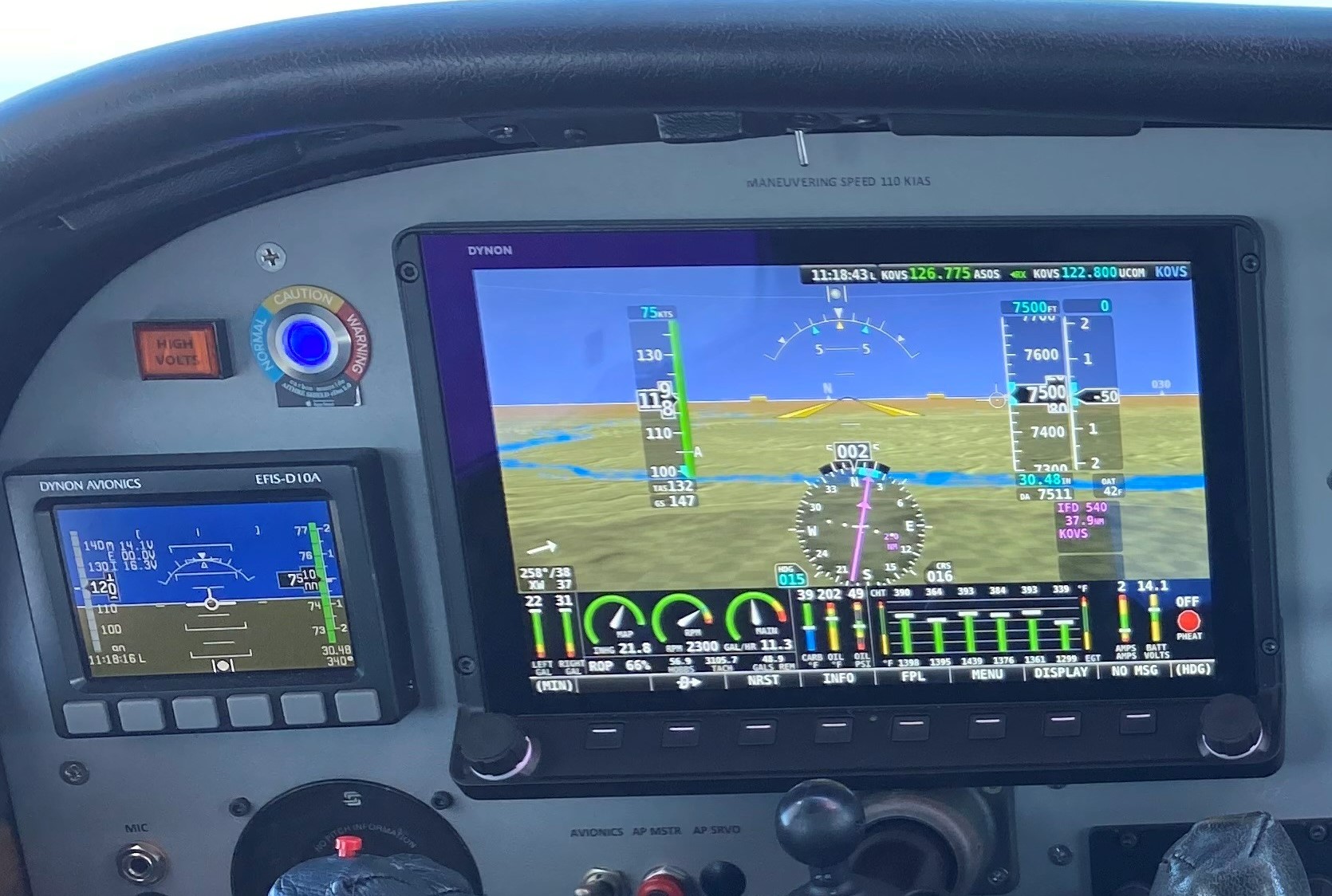

I installed the eDot 5.0 in my panel a while ago and couldn't be happier. While it doesn't connect into my Dynon, I located the indicator in my sight line. Its the deep blue dot in the upper left corner.
