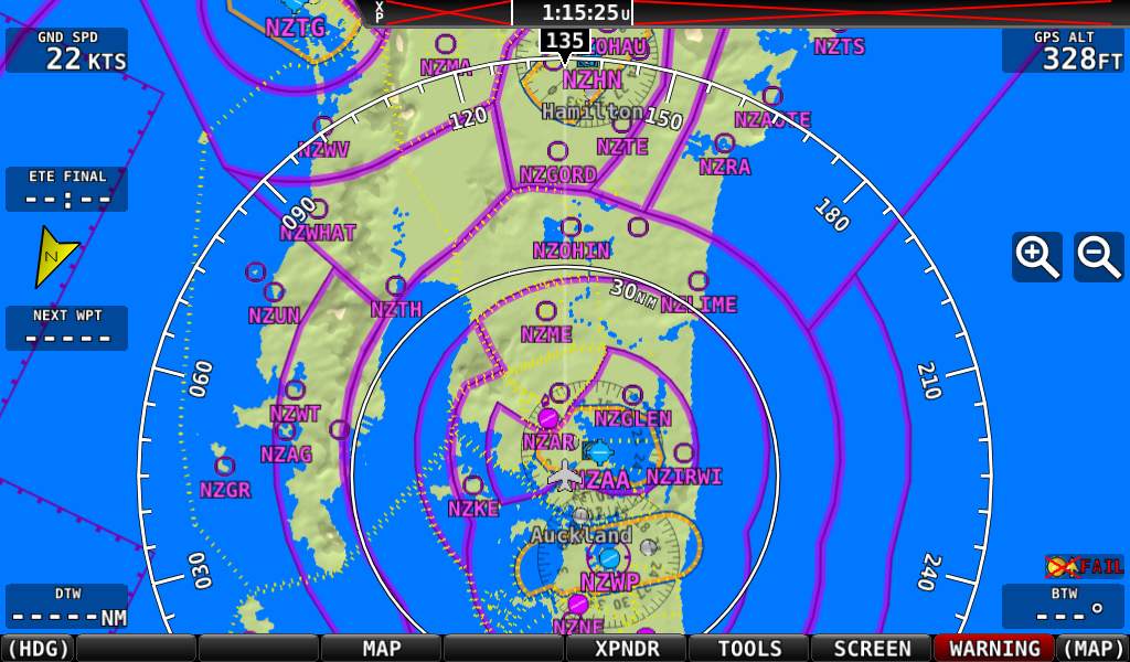

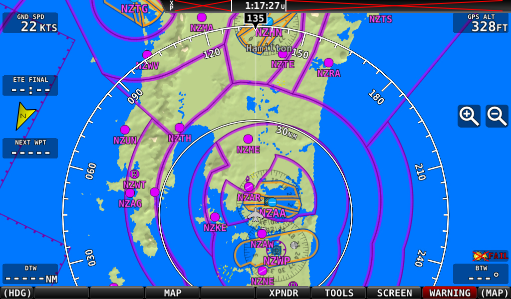

3) We can post a couple of images for you here. Is there an airport / area that you'd particularly like to see? Generally, Pocket FMS is stronger on the private airports that sport pilots typically use.

For map screen shots around the Auckland area would be great thanks.
Thanks John
Aukland area: PocketFMS

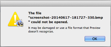

Sorry to be a pain but my Mac wont open a bmp file, any change of a jpeg? :)
Your Mac's browser may not have native support for .bmp files, but the Mac's Preview App should be able to open / view them. Just save the image files to your desktop and then click on them - Preview should then open them.

Yes I tried that using preview but got a file corrupted message as attached.
