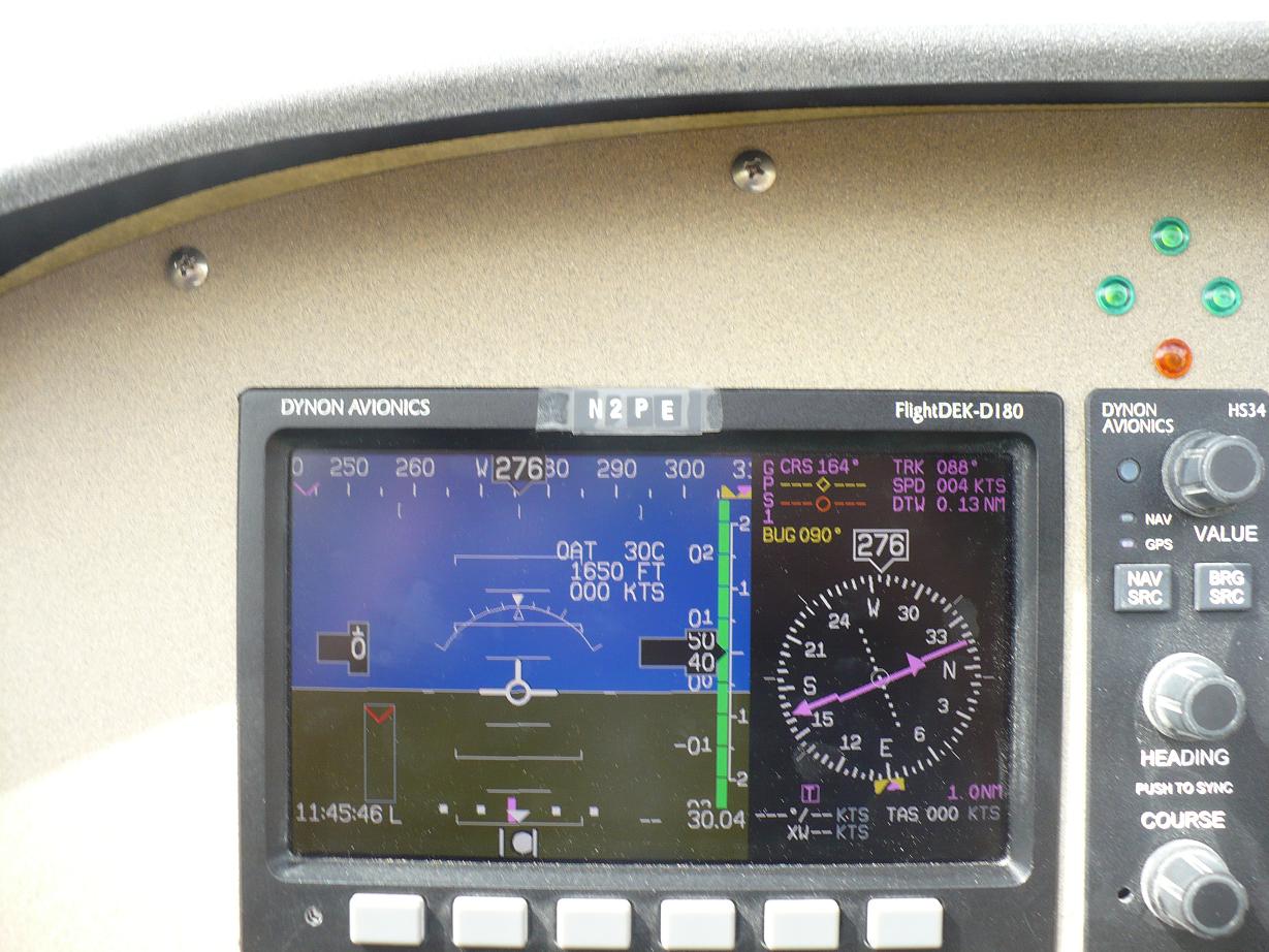

OK, I've reattached the wings and got her back in the air and here is a picture with the HSI screen and EFIS showing wind direction and speed. Any suggestions???

Your picture doesn't show IAS on the left hand side of the screen. Do you happen to know what it was?
Your compass says you were flying 273. Your GPS says you were tracking over the ground almost 180 degrees off- 079. Only one of these can be right. Which one was? Were you flying East or West at the time the pic was taken?
So that tells us the EFIS is right and the GPS is wrong. Next time you fly, look at the track on the GPS and on our screen and see if they don't match. If they do match, it's a Garmin issue and you'll need to contact them.
What software version are you running? We did have a track bug with the 430 if you were in certain places on the earth, that was fixed well over a year ago I believe.

These pictures were taken on the taxiway, moving slowely west. The Garmin 430 shows the correct track, consistent with the DG and thw wiskey compass. Even the TruTrak auto pilot which will fly the GPS flies the correct way. The only discrepency seems to be the track on the EFIS HSI page. How can this be? Everyone is out of step except my son??

I see you're in Florida, which is the exact place we first found the bug in the HS-34 that I mentioned. So we really need to know what version of software is on the HS-34 and the display, since chances are very good an update will fix this.

I understand the version in the HS-34 is the same as the EFIS, which is version 4.0.0. Guess I need to download the new 5.1.1 and install and see how that works.
Yeah, 4.0 had that problem for sure so an update will fix it.
