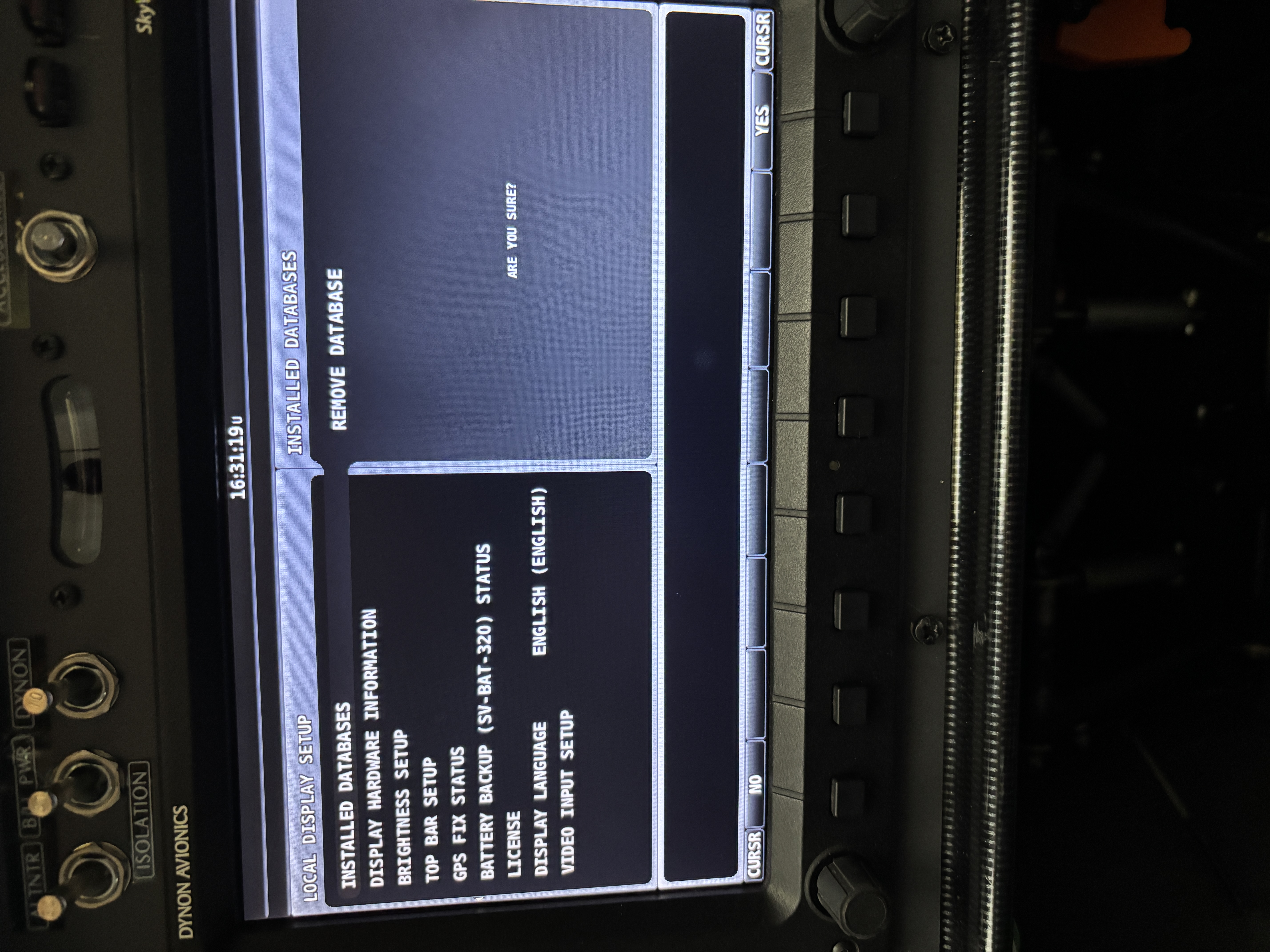

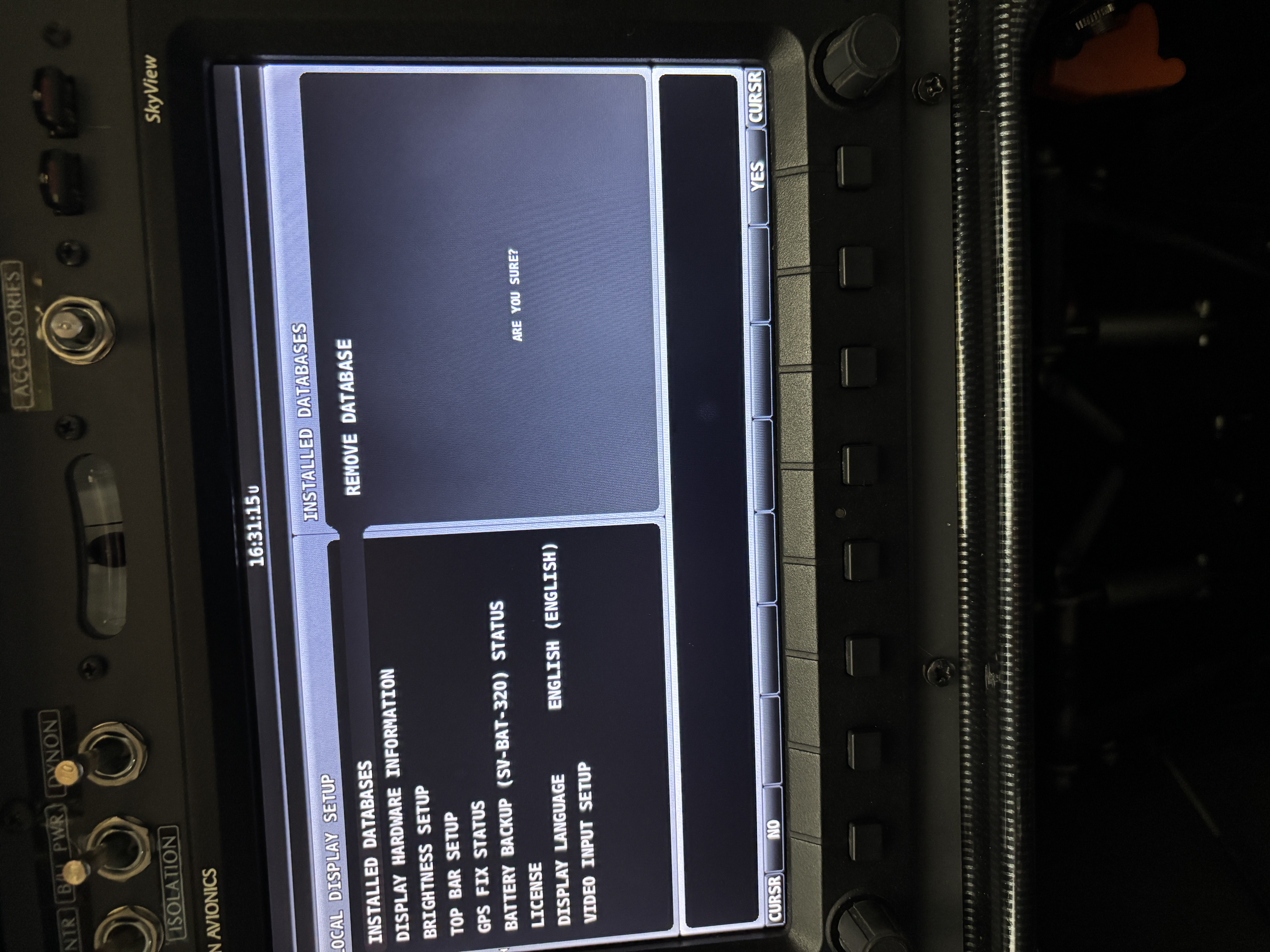

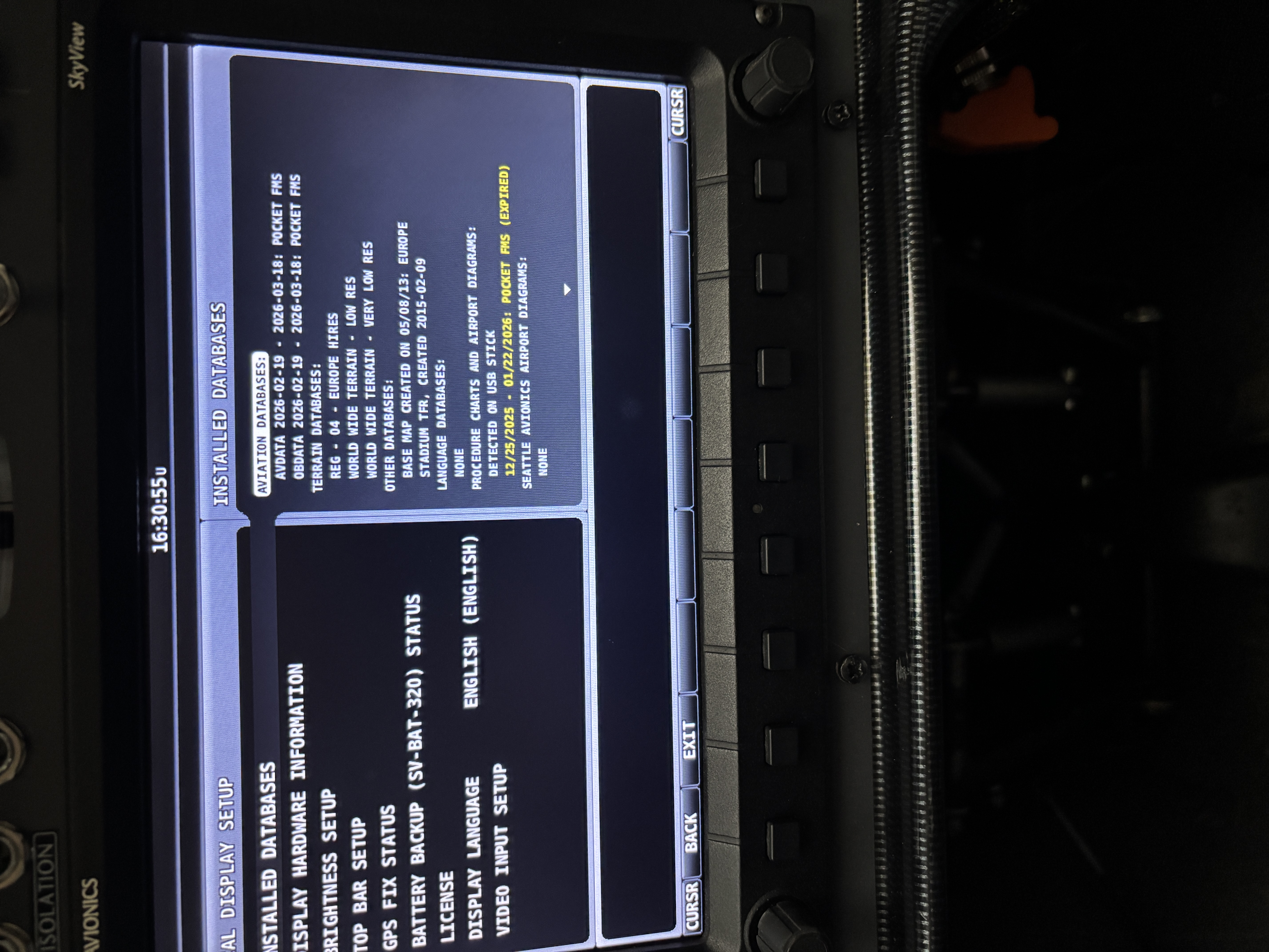

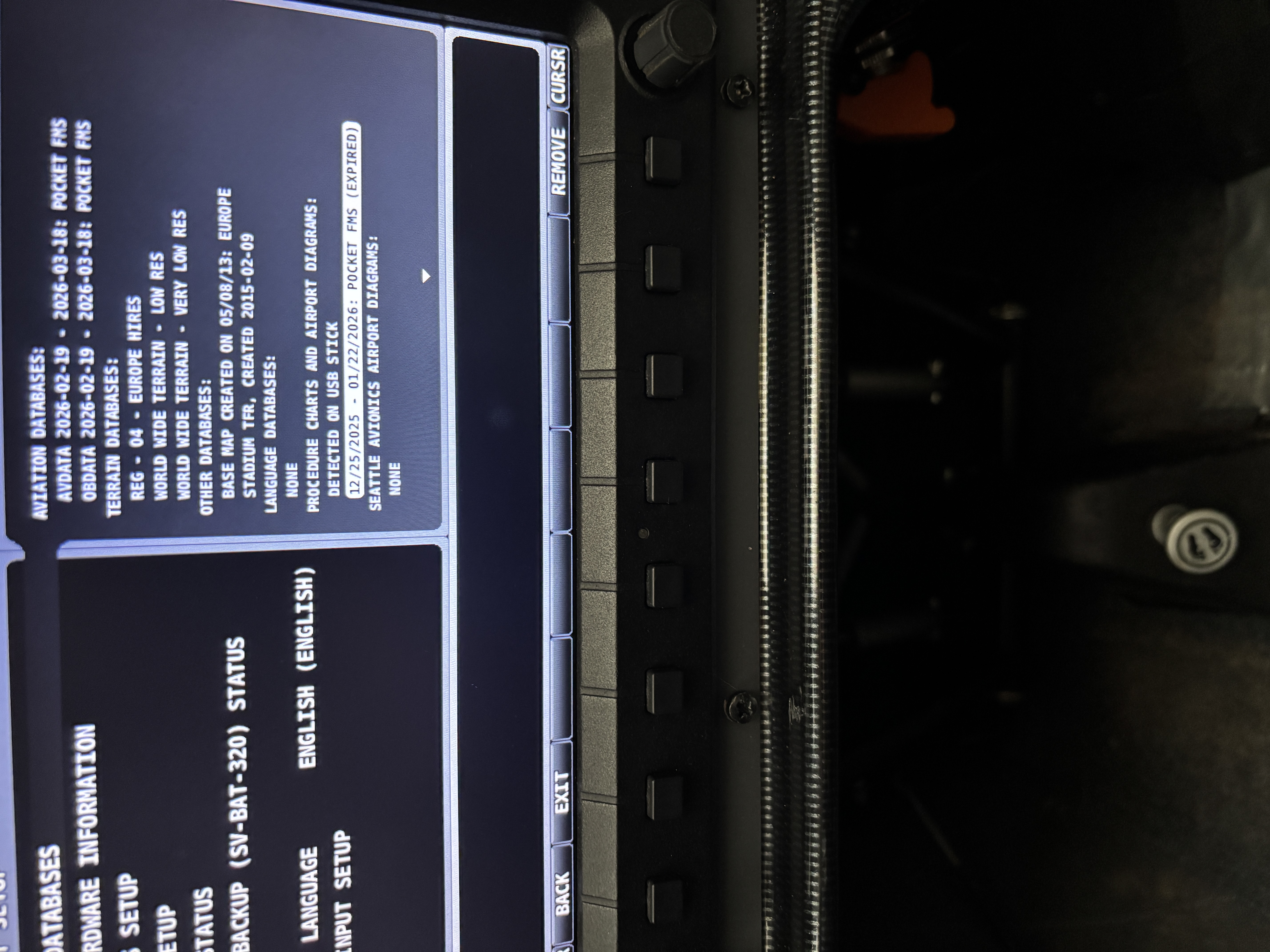

I have a very similar problem and continue getting the Database not current message at startup. I can live with it but I'd rather not! I have a 10' and 7' screen (classic, not HDX) and the responsible file is highlighted in yellow on the >Set up >load files screen. This happens if I got to the load files menu on either screen (same file name) and when I try to remove it using the Dynon 'remove file' option I'm asked to confirm with a yes but the file is not removed; I've followed that process on both screen and the fellow wont go away. The file is referenced on the start up message and highlighted in yellow on the load files screen! I've deleted the .DUP files from the USB sticks and reload both from my Pocket FMS account Nav and Obj files onto both sticks - still can't delete from the Dynon kit. It must be held in the Dynon kit itself somewhere. Photos attached I hope. Any ideas?

I hope somebody knows what I'm missing, if not I will re-format both USB sticks and reload from there.........
