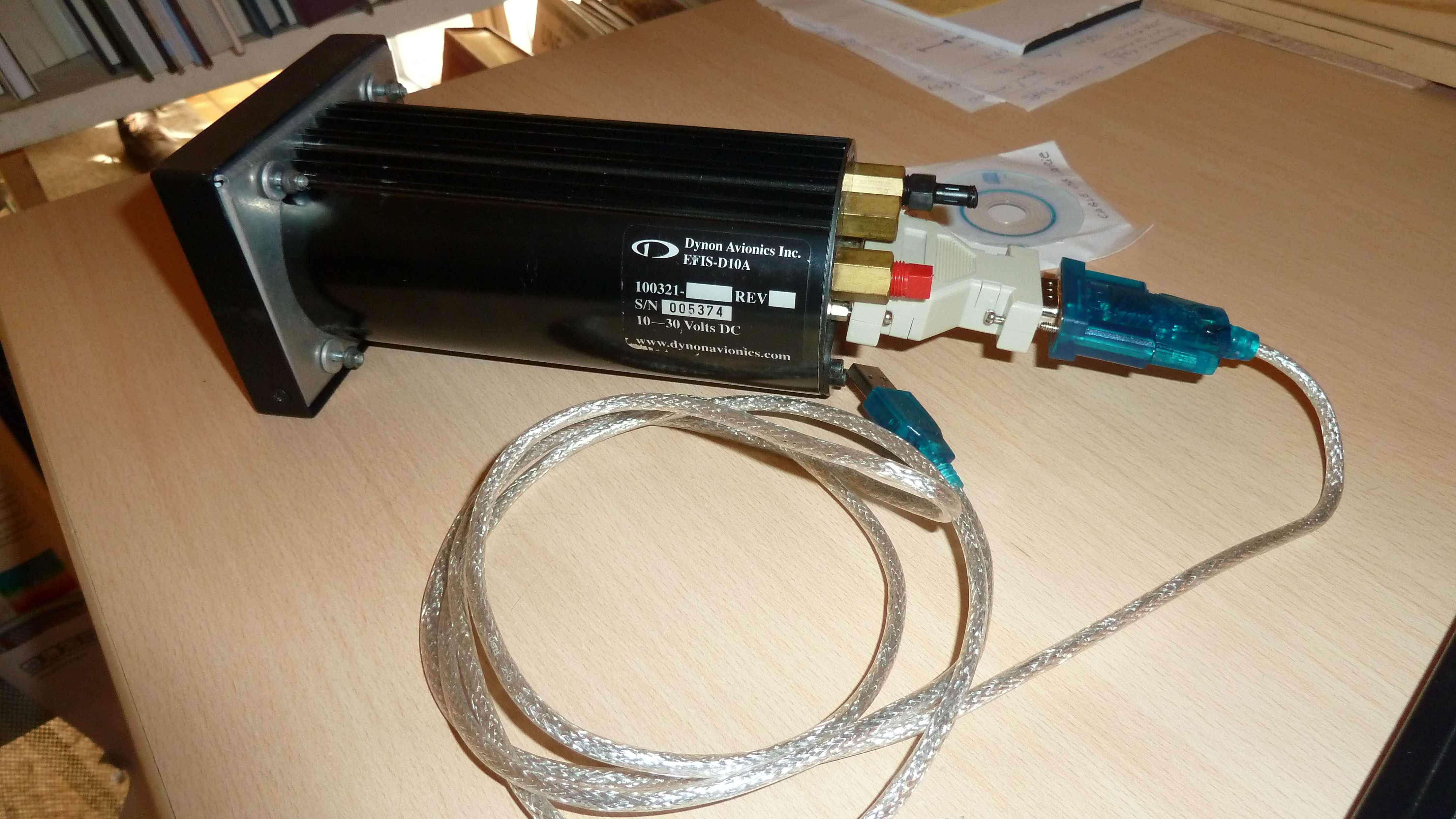

I must be very stupid... I still do not see how you can connect a D10A to a power source when it is removed from the aircraft and connected to the USB port of a PC via a USB to serial wire (the screen remains turned off, how can I have access to n°1 power supply pin?)
The back of the Dynon has a 25 pin connector, but it's not JUST a serial port. It's a D25 connector that contains connections for power, ground, a serial port, audio, and more. So whatever that D25 to D9 is that you've connected (an old style serial port converter, probably), it's not going to work at all.
Take a look at page 2-2 and 2-4 of the D10A install manual at http://dynonavionics.com/docs/support_documentation.html.
You need to either build a 25 pin harness that has power, ground, and the 9 pin serial port hanging off of it as shown. Or, alternatively, you can buy a spare D10A harness from us ($90) to see how that 25 pin connector needs to be broken out.
Take a look at page 2-2 and 2-4 of the D10A install manual at http://dynonavionics.com/docs/support_documentation.html to see how the connections on our D25 break out.
