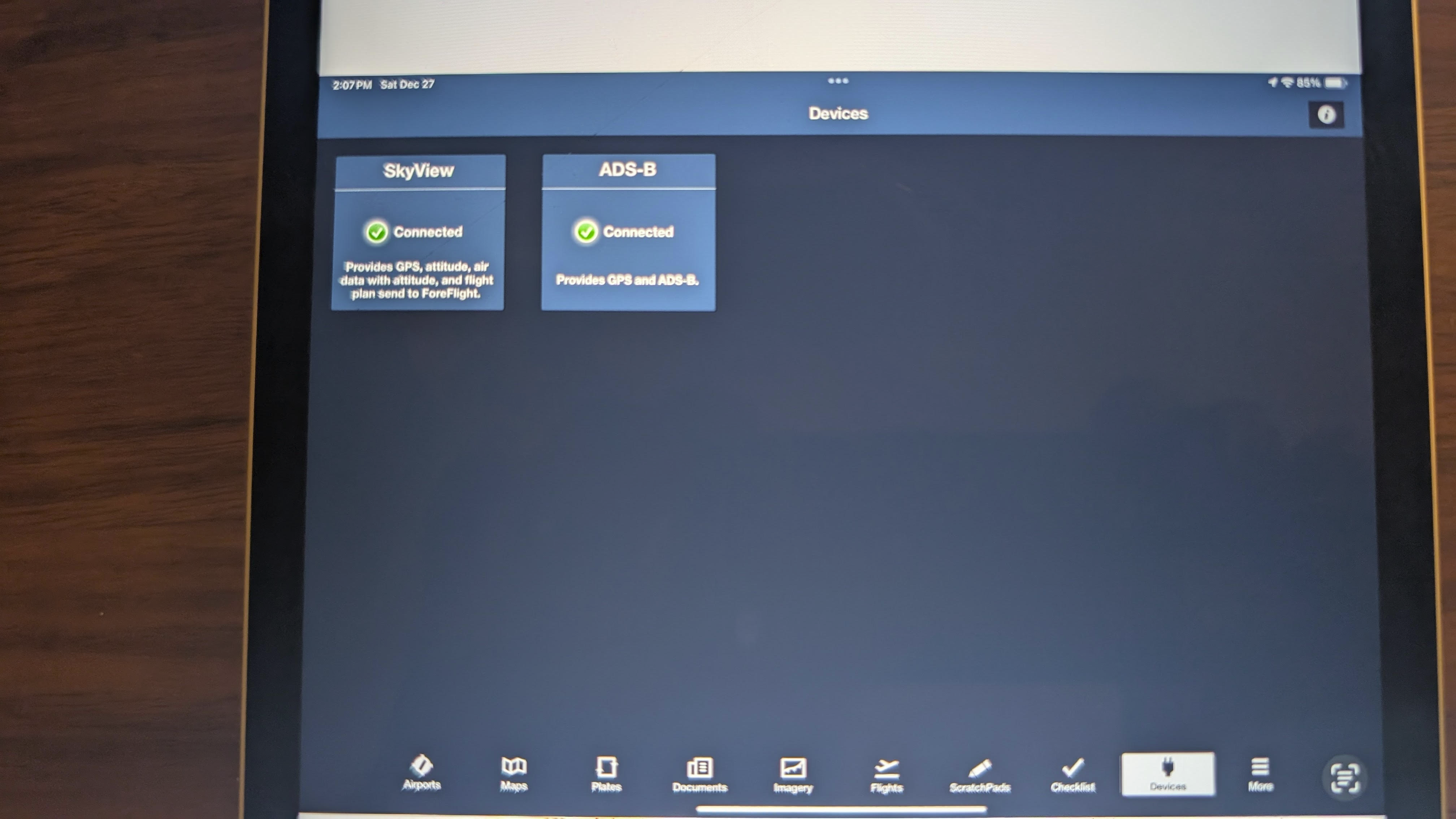

Hi team. I am also having trouble with Foreflight and HDX. I've got a stratux installed in my plane and it it rock solid, However, I recently bought the official wifi dongle from Dynon, but I'm having stability issues. Mostly the GPS location crapping out randomly in flight. Wifi dongle is plugged directly into the back of the hdx.
I also see 2 devices on foreflight, Skyview and ADS-B.. I had to turn off GPS on the ADSB source to get things working. I've not seen this in any documentation. Is this normal?

Are you saying the Foreflight worked with Stratux before and now it doesn't?
The wifi signal from the Dynon dongle is not very strong. The iPad needs to be located very close to the HDX unit or the Foreflight will disconnect intermittently. I have an RV8. The Foreflight wifi connection from the rear seat is not very reliable. I had to mount the iPad right next to the front panel less than 6 inches away from the HDX unit.

Yes works great with Stratux... however I get some static in my radios from Stratux.. plus I want a ADSB backup. I cannot believe the dongle is that weak.. it's only 2 feet away! Signal indicates strong on the ipad...
