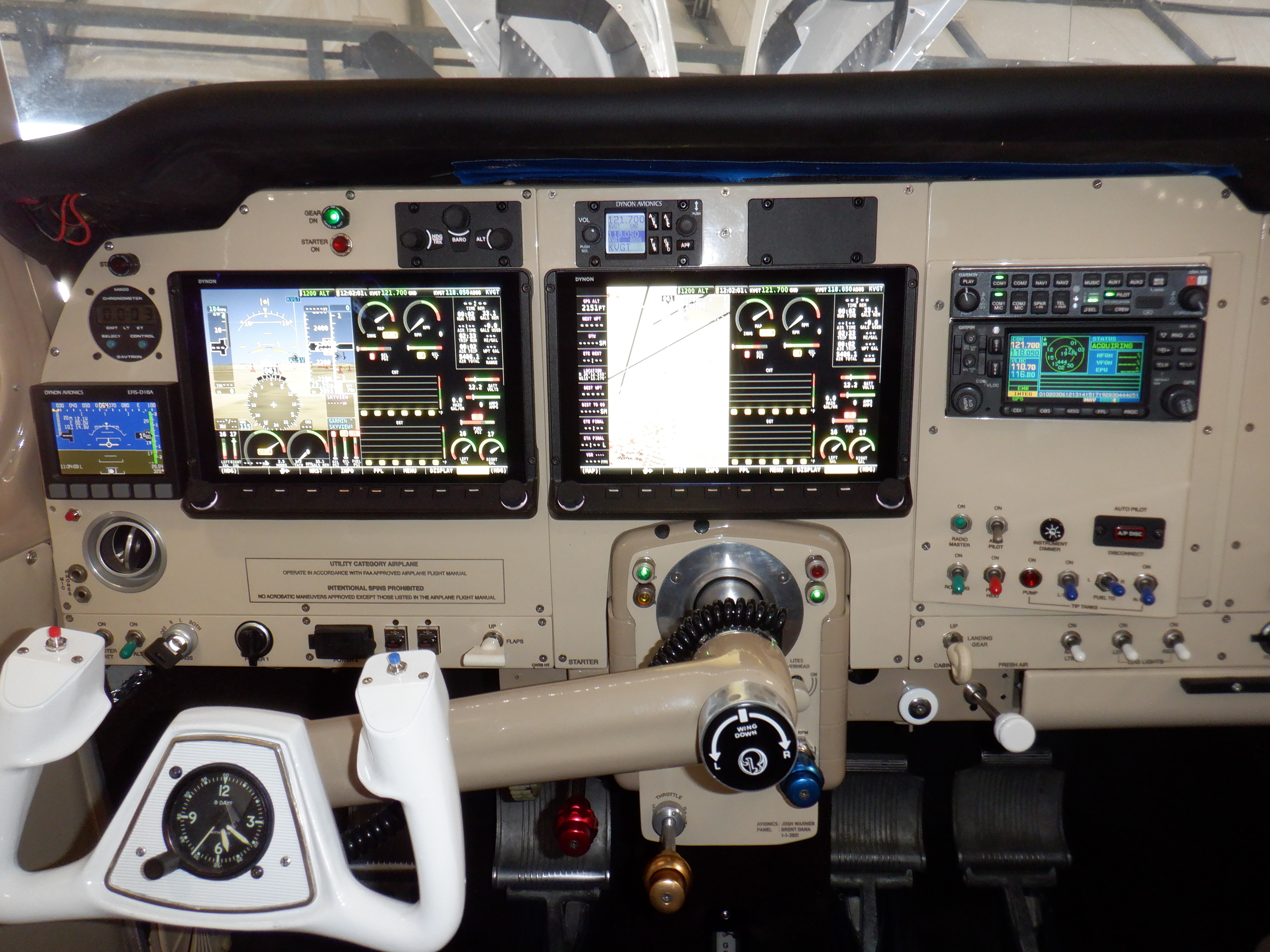

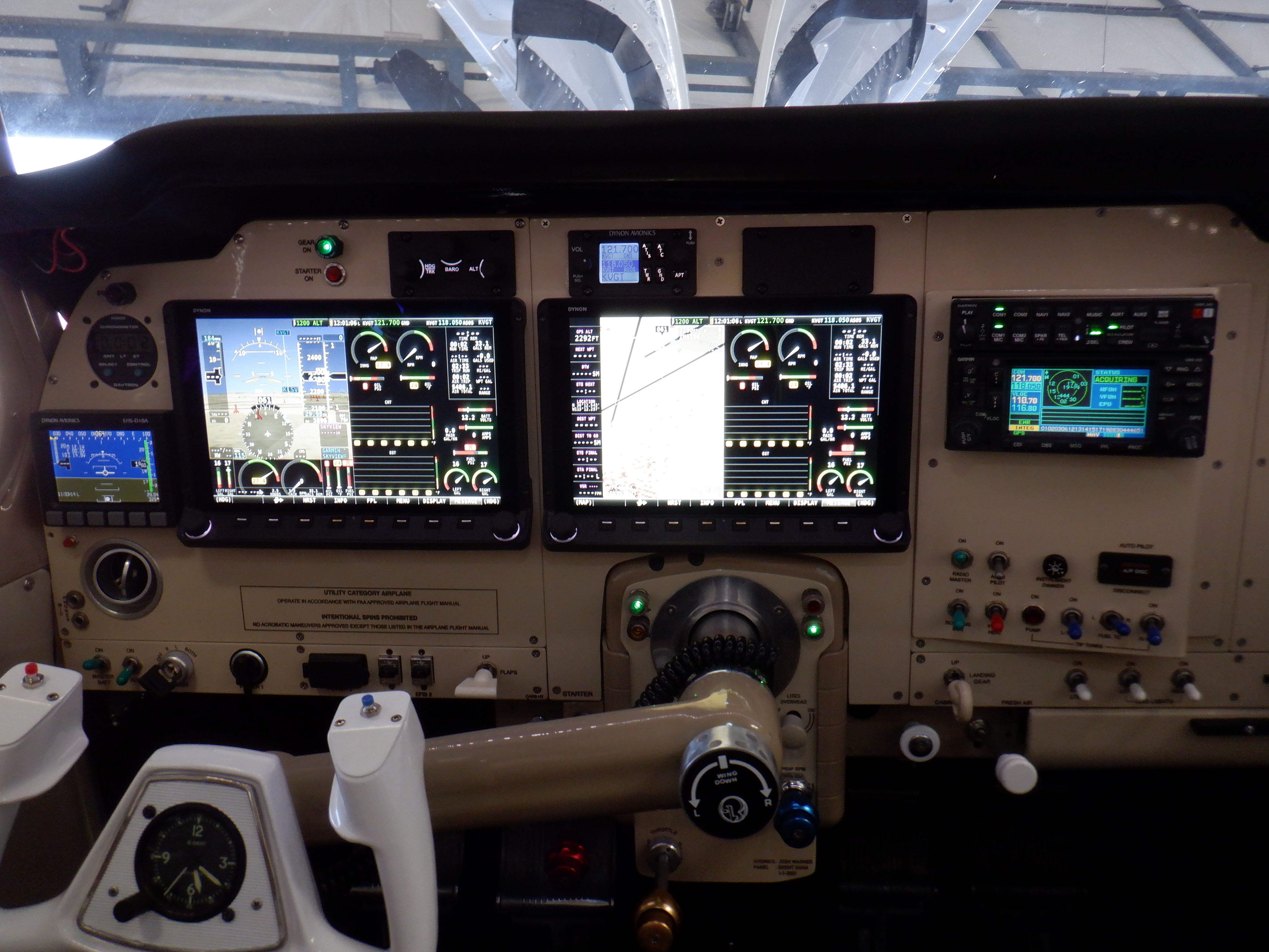

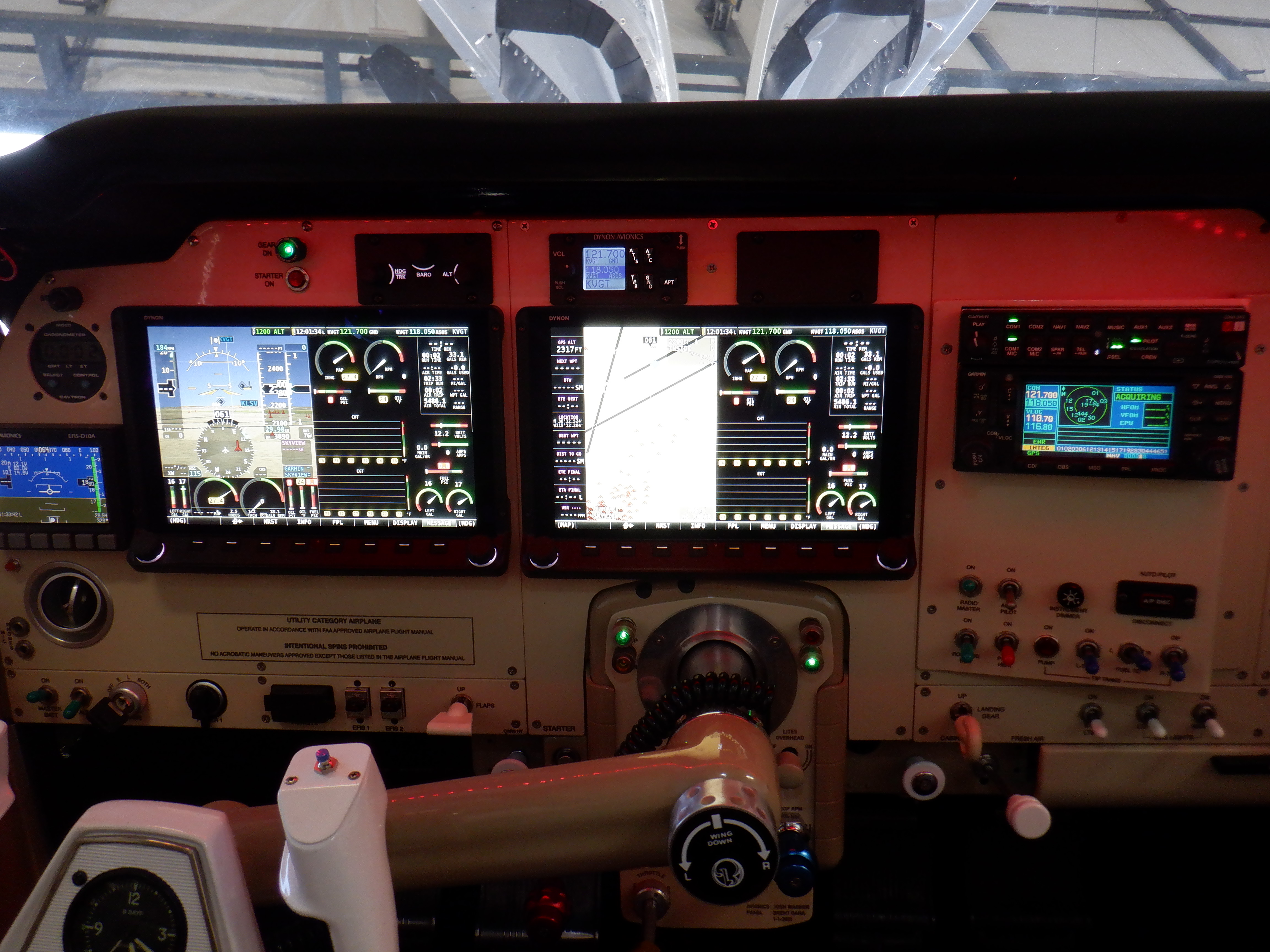

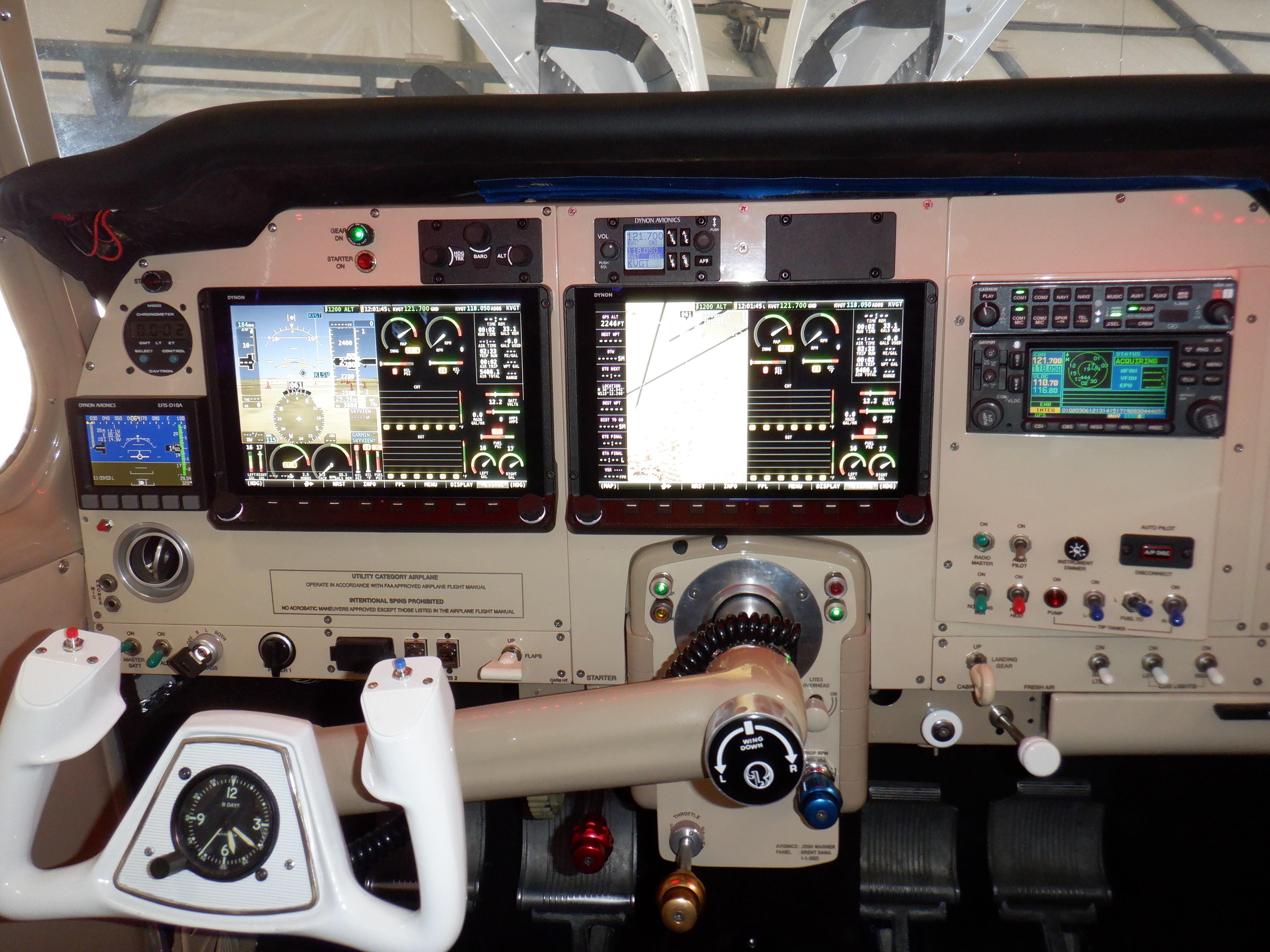

Better pics today, as done 63EDE247-9842-48CF-A2E1-F04F841FF05B.jpegBF785FD4-8CE1-43EF-90A7-2FCD15E6B8CC.jpegDC6E4A20-373E-423E-8E5F-D391C27E53BA.jpeg225DDEFE-D036-4297-9CE6-5A571427AB7B.jpeg8FA860FF-169C-4FCF-89D2-C3B6D9344BD1.jpeg6560330D-A2BF-4733-B9DA-422CB6D403E1.jpegC1F72E9E-E1F3-4E1D-8E6C-8C0C0092A282.jpegC39D1338-2903-403C-BB16-7D1F5417CE06.jpeg

I really like how your panel is organized, is that SRS, McPeck or some other design? I'm at a position of needing to figure out which way to go for my H35.

It was an ars panel, and i just put my own design over it. One thing i figured out last night. Landing lights and wing fuel pumps should be reverse position. Other than that happy with it.
I wanted it like an airline, knowing how hard it is to get under that dash, if there is an issue down the road. By doung seperate panels, it allows me to handle any issue, sitting in the seat, within 5 mins, the back of the instrument is in my lap. All goes back in, in 14 mins.
