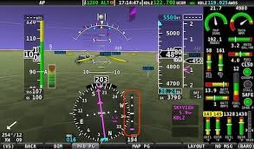

Even following the instructions in the manual I have not been able to make an approach using VNAV,does anyone heve experience in this ?
Spert
Dec 26, 2020
57
Is this an autopilot question, or are you not seeing the glide slope information?

the glide slope works perfectly on all airfields but it doesn't work for me and it doesn't appear when i want to do a vnav descent, my screen is a Dynon HDX 100 and the approach data is in the airmate software
It sounds to me like your talking about autopilot use vice approaches. Can you clarify?
If it’s working on approaches, but not when you are doing an enroute descent, you may need help from someone who has the autopilot, which, unfortunately, is not yet available for my PA-32
