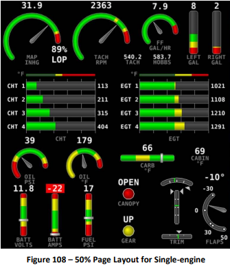

I'm pretty sure you can set it up with the labels you want in the 50% page, depending on which widgets you choose.
In the bottom band display I've not seen it, probably due to space limitations, and there would be a confusing amount of numbers.

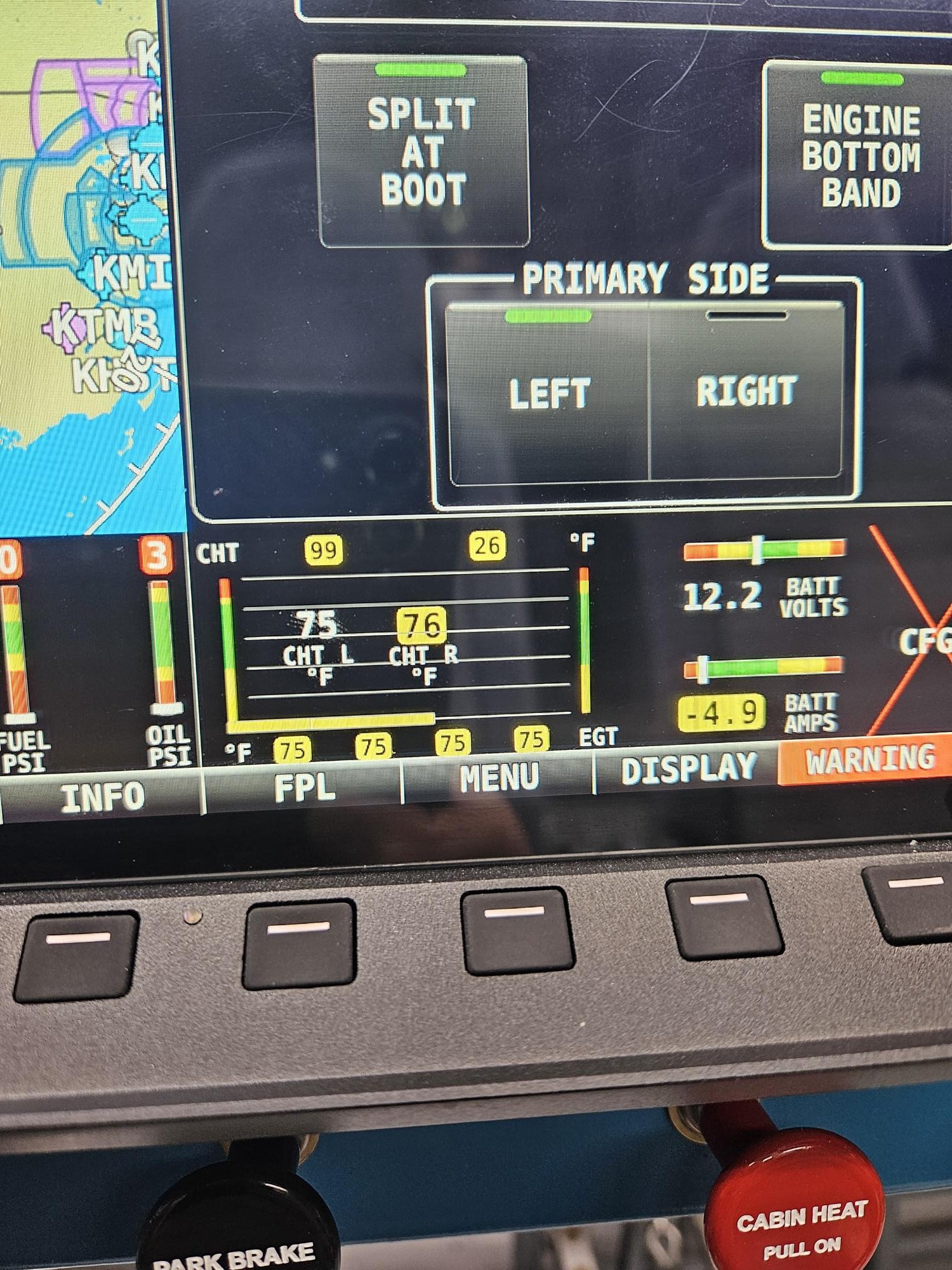

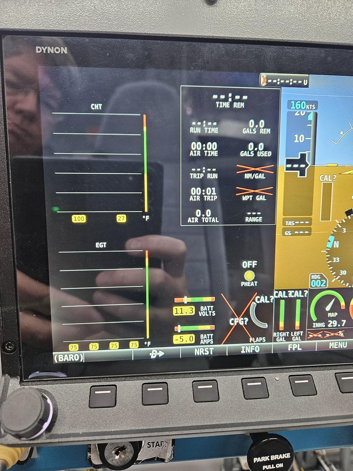

Hi Glenn,
I should say that I have installed all the Dynon system components and I am playing with the setup and configuration.
1. On some screens, I can see "CHT L" and "CHT R" with the correct (room) temperatures displayed. On the screen below, I see 100 and 27 displayed with no labels. What are those?? Maybe MAX and MIN? But there are 2 CHT sensors... ??
2. See the 4 EGTs on the screen below. No labels, but looks like plenty of room? I looked in the sensor mapping and they are setup to display "EGT 1", etc.

Attached is a different photo. Inside the graph it shows 75 and 76 degrees F for the Left and Right CHTs respectively. These are correct readings. At the top of the graph, "99" and "26" are displayed... What are these numbers? When I play with the screen editor, these values show up as CHT readings (incorrect). For the life of me, I cannot figure out what these two numbers are! Help!
