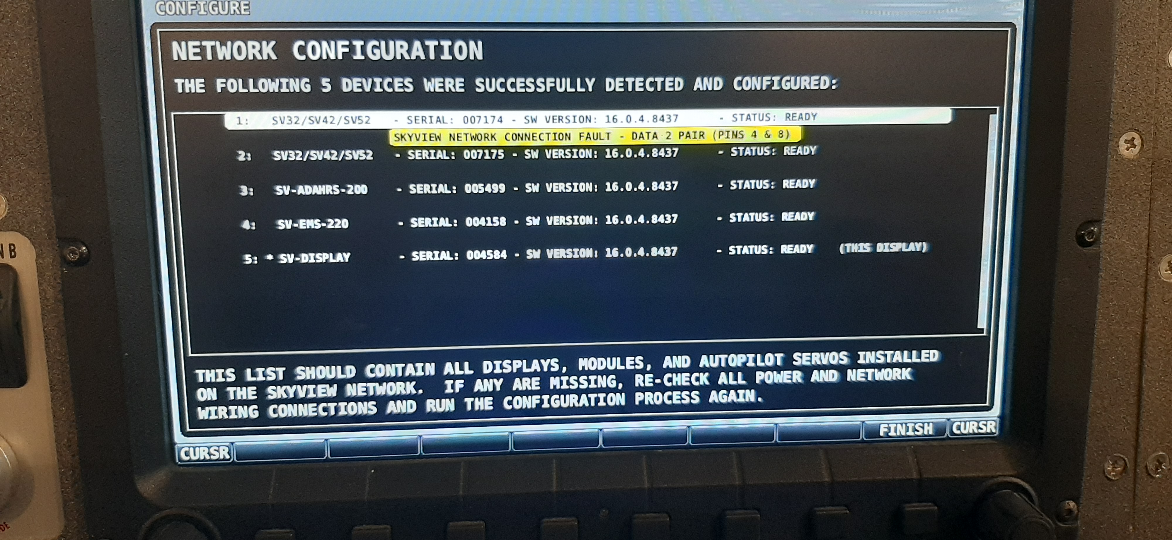

I am assisting the builder of an ELSA RV-12 to diagnose an issue with his roll auto-pilot servo generating " Skyview network connection fault Data 2 pair (Pins 4 & 8) "
-Dynon D1000 screen version 16.0.4.8437 installed
-SV32 servo (serial number 007174, in case that helps with age). Network status indicates the servo has version 16.0.4.8437 also installed
-Auto-pilot is functional 95% of the time on the primary network, I've had a few occasions that the secondary network issue appears to have caused the auto-pilot to disconnect.

I created a new diagnostic file after completing this latest round of testing. It is 100mb
***FIXED***
Short answer: "Options" port of AV5000 had white with green and white with blue pins reversed. Correct pins are: P3=White with green, P4= White with Blue.

Don Jones from Dynon quickly responded to my support email with the above information. He had worked with another rv-12 builder to find a faulty wire. Unfortunately, my issue appears different. Update:
I reach perfect continuity of the roll servo in the "options" av5000 connector while the pitch is in the "fuselage" av5000 connector. Any RV-12 builders out there willing to share with me the av5000 powerbox pin out, please?
owenssonex
Jul 22, 2019
45
Ugh... it is finally really fixed!! The Options connector on the av5000 had pins 3 and 4 swapped. "Options" Pin 3 should be white with a green stripe. Pin 4 white with blue stripe.
Dynon network status reports happy happy.
