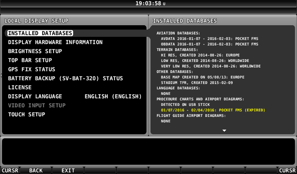

Do we have a fix for the expired database issue yet? I've been getting this warning since I purchased and installed my D1000 last month. I'm using an up-to-date PocketFMS database. It's never successfully read the database, so I don't know what is missing from my display as a result of this problem. Can you confirm?

So we thought we had it fixed with them. When is your database from? What do you see in the INSTALLED DATABASES page? What do you mean by "it's never successfully read the database"?

Apologies. I didn't realise you had to manually import the updated databases. I thought they updated automatically if they were on the stick.
So, the only issue that remains is that the system reports that the charts expired when they haven't. See the attached images:
