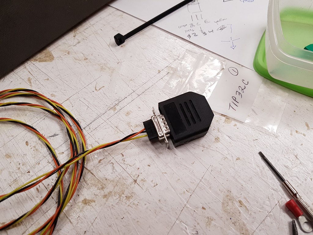

I'd like to thank HomeBuilt101 for asking the question, Vern for supplying an answer and Dynon for having the foresight to build the function into the Skyview.
I had the panel out for other things so I built a gizmo according to Vern's instructions. I have eleven RockRack switches that draw 180 mA and a LED strip that draws 270 mA. More than the 120mA that Skyview will handle. I used a TIP32C PNP transistor (~3A). It draws about 3 mA at the BASE with a full load. Skyview should have no problem handling that on pin c37p26.
I purchased the SV-KNOB-DIMMER for the input on pin c37p25. I also spliced in my radio and xponder to the DIMMER output. The whole frigging panel dims when I turn the knob. No smoke either :) :)
The gizmo was easy to make. I just crimped dsub pins to the transistor and covered it with a case. No soldering involved. I used another dsub to wire it to Skyview pin c37p26 (BASE), GND (COLLECTOR) and the ground leads of my LED's (EMITTER).
