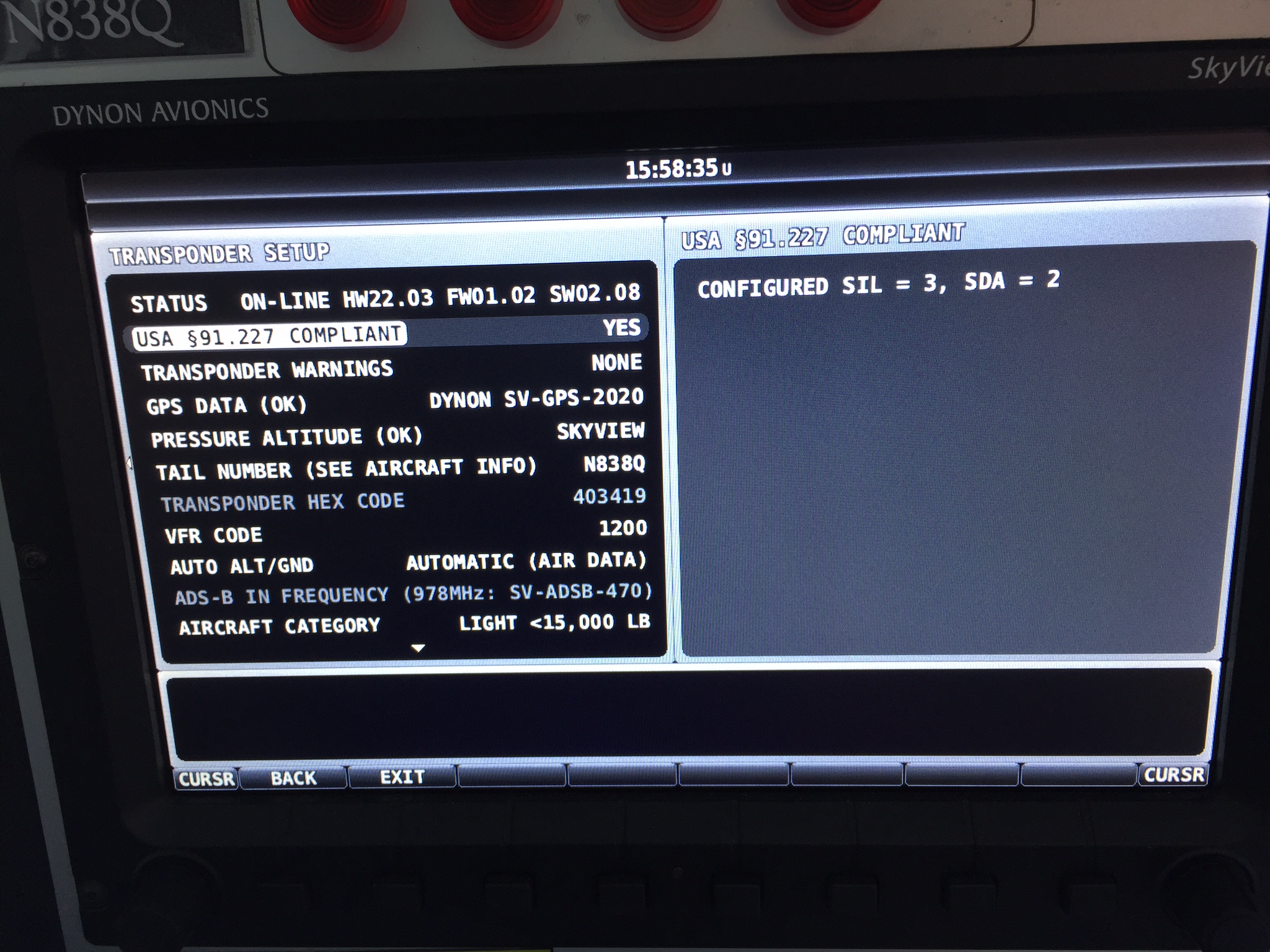

hmmmm....My Transponder Hexcode on Skyview v14 says 403419 but on the FAA page it says AB7770.   The Octal Code is 52673560 so its not close to that number either.  I have another open post saying FAA and Flightaware don't have my new 2020 ADS-B data in system.  Related?  Thanks!

On which screen should I change the Tail Number, Steve, to see if auto-correct will work? If that fails, on which screen can I change the Hex Code directly? You can see on my Transponder Set-up Page snapshot its greyed out implying I can't change it there?
Doesn't matter which screen you change it on.
You can't set the HEX code manually in v14 if you are in the USA. SkyView calculates it from your tail number and we've never seen it be wrong. The issue for you is that it was set wrong in v11, and when you upgraded to v14 it keeps the old number. It only updates the number when you change your tail number.
You must change the tail number in SYSTEM SETUP -> AIRCRAFT INFO. The HEX code is there too and you'll see it magically change.
On either display, change the tail number, by one letter or number, and then change it back to the correct tail number. As soon as the SkyView display sees the tail number changed, it will automatically update the HEX code accordingly.
That SkyView display will then share the tail number, and updated HEX CODE, with the other display.
To answer your earlier question - "... FAA and Flightaware don't have my new 2020 ADS-B data in system.", yes, this incorrect HEX CODE is why your flights were not in those systems (under your correct tail number / HEX CODE).
