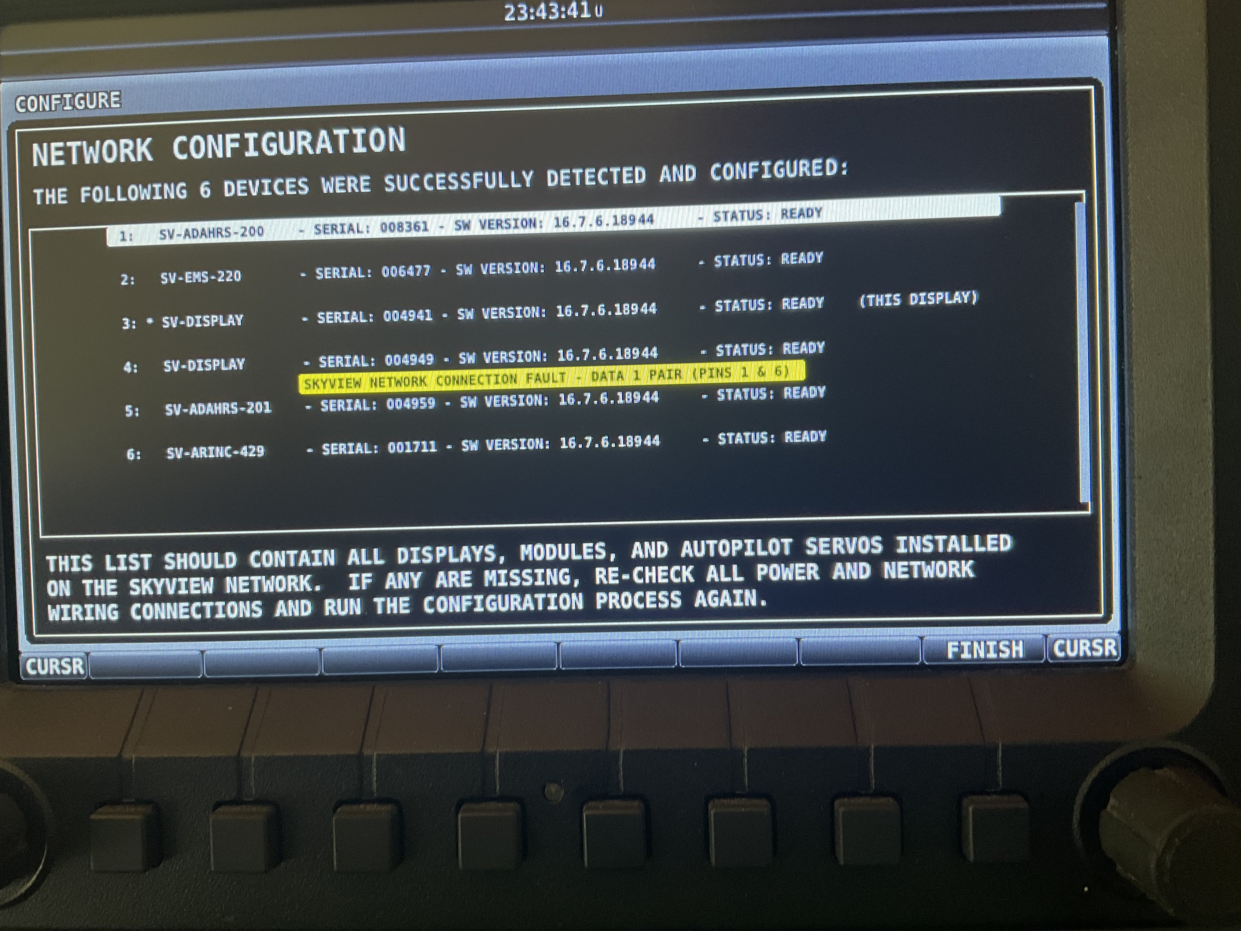

I just updated the software on my two screen skyview classic system, but I did not realize I needed to reconfigure after updating. I have not done this with previous updates and have never had an issue. While flying today I lost the transponder and eventually both screens were all red X‘s. I did the reconfigure and ended up with NETWORK CONNECTION FAULT - DATA 1 PAIR (pins 1 and 6). See photo attached.
Any advise?

Check the wiring and connectors. Are you using a hub?

Do as the fault suggested - check pins 1 & 6 on the network cables. I’d start first with any network cables you made up as you may have missed making sure they locked into place 😉.

I did a continuity check on the network cable connected to the problem screen. I really had to dig around in the pin holes to make contact. I’ve replaced the cable and hopefully I can fly it in the next couple days and see how it does. Ground checks are good, but the problem only manifests after 20-30 minutes of flight. The new cable was very easy to make contact with the pins. The old and new cables were sourced from Dynon.
2,267
Ok, unless you’ve removed the backshells & THEN did a gentle pull test on the wires, you’ll never know if the old cable was the issue.
Using a DMM to test connections, just tells you the wire & connections are either good or bad, however there have been instances where the pins/sockets were not ‘locked in’ to the dsub connectors - that‘s a good reason why the ‘Pull Test’ (not too hard a pull) is universally suggested for many/most crimp connections. HTH 😉
