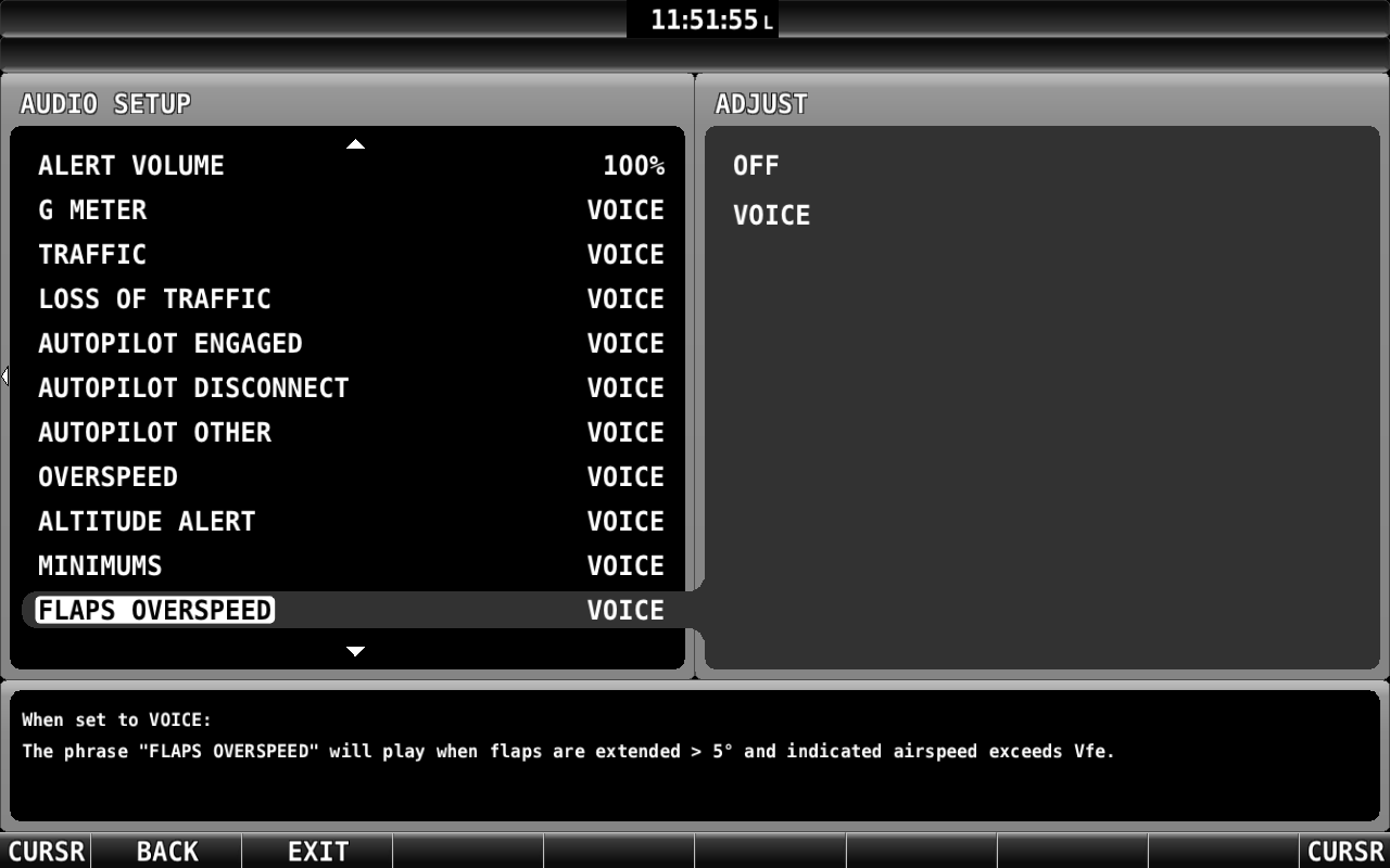

andresmith76
Oct 4, 2018
179
I have the flap sensor, but could not find the "Flap Overspeed" audio selection so I used "Gear Overspeed" instead, so now when my flaps are deployed > 95 Kt, I get "Gear Overspeed" but would like to change it to "Flap Overspeed" but I could not find that in the config menu? Can you tell me where in the menu structure you found it?
Thx
Steve
The Flaps Overspeed audio annunciation selection can be found in SYSTEM SETUP > AUDIO SETUP > FLAPS OVERSPEED menu. There are multiple selections available in the AUDIO SETUP menu, requiring you scroll down quite a bit to find it.
