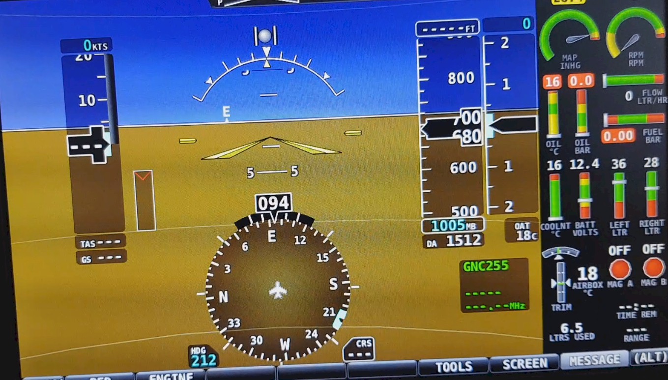

our flight club has a brandnew Dynamic WT 9 airplane with Dynon Skyview D1000 Display and ADAHRS Module. After several flights, I recognized, that the pitch was not shown correctly. See the attached picture. And I'm quite sure, that it was ok during the first flights.

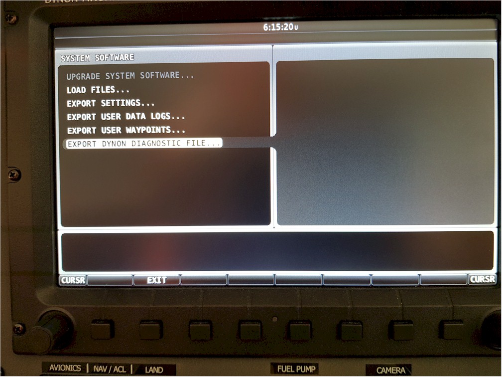

Pushing knobs 7 and 8 and enter the Setup Menu, there should be a way to adjust the displayed pitch of the waterline symbol. Unfortunately I didn't have this setup menu. Starting the display with the Dynon USB-Stick attached I have only the software Menu (Picture attached).
Do I need another software on the USB device to enter this menu and is this the right way adjusting the pitch or is this maybe a problem of the installed ADAHRS Module?

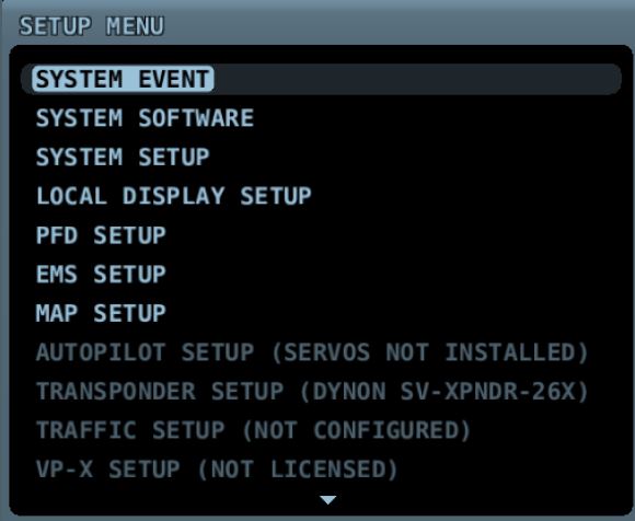

go back a few pages to 3-10 and you'll see attachment- chose the "PFD Setup" and thats where you adjust the angle. your screen shows under the "system settings"

You will need to adjust this in flight if you want it straight and level when you are S&L. To do that you have to access the full menu. and then go to PFD setup.

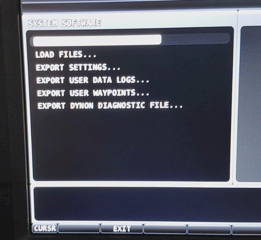

Yepp, I tried that. Unfortunately I didn't get this Setup Menu. The system automatically jumps in the software menu and there is no chance to go one step back.
As you can see on the attached picture, there is no white arrow to go back and the UPGRADE SYSTEM SOFTWARE Menu is grayed out.
I think, the problem is the stick I received.
I tried this also with the second USB device and the second display and vice versa without change of the results :(

The adjustment has nothing to do with USB sticks or loading any software. Just go to System Setup->PFD Setup where you will find the adjust pitch control. Also, to go back one step push the key labeled "Exit"

I note that pitch adjust should be available in flight setup. I’m not sure you tried that.
Then there is czech aircraft SB that says holding button 7 while booting SV from off will put you into a setup mode. Could you try that?
