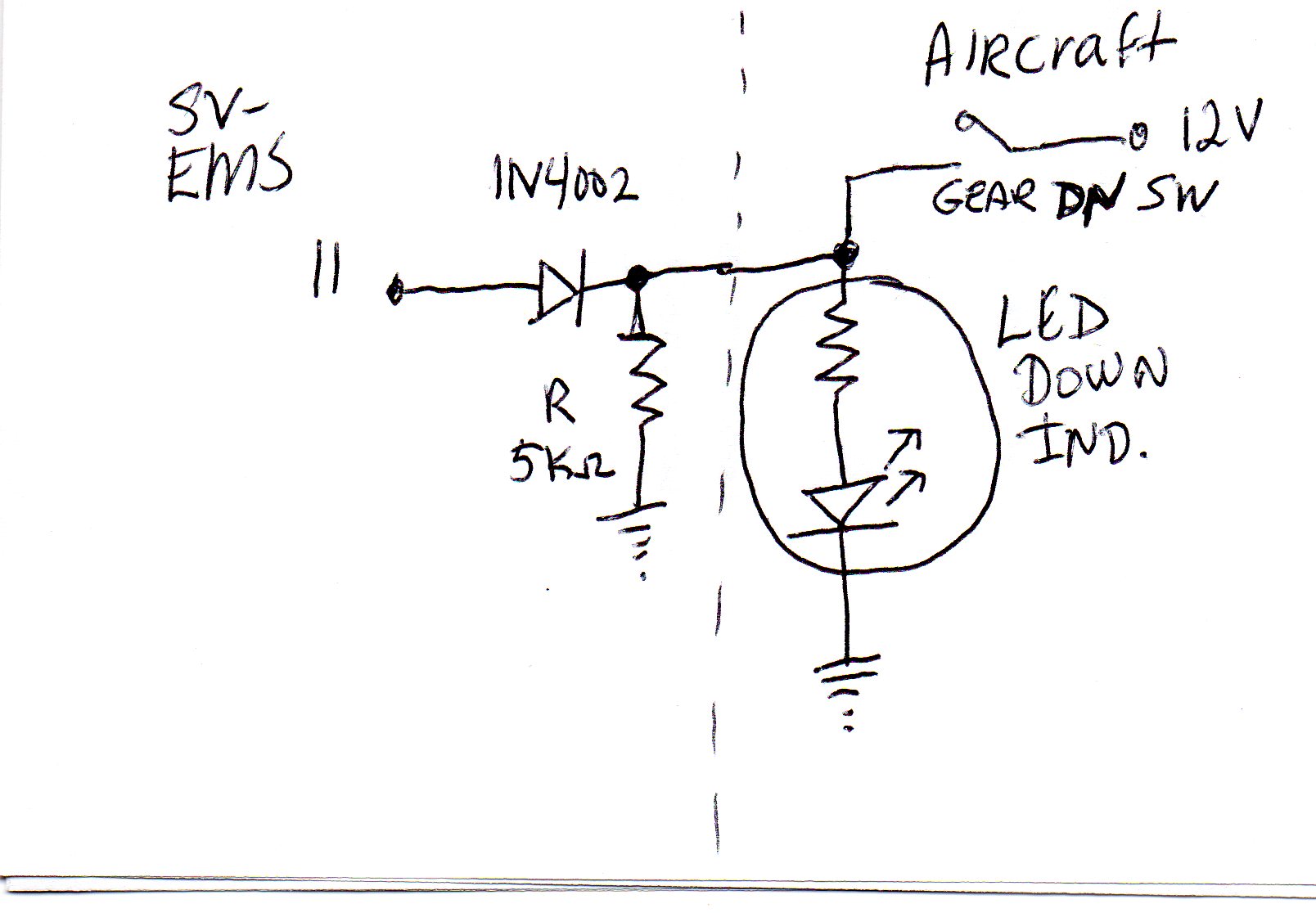

Homebuilt101,
Dynon can confirm this, but I believe if you are tapping off of LED's the "open or off" state may be too high impedance and not "pull down" the contact input enough to get a low "Gear Up" indication.  If this is the case you will need to add a pull down resistor ~5K Ohm should work.  An incandescent lamp will not require a "Pull Down".  Also, I recommend you put a diode in series with the contact inputs to provide isolation.
