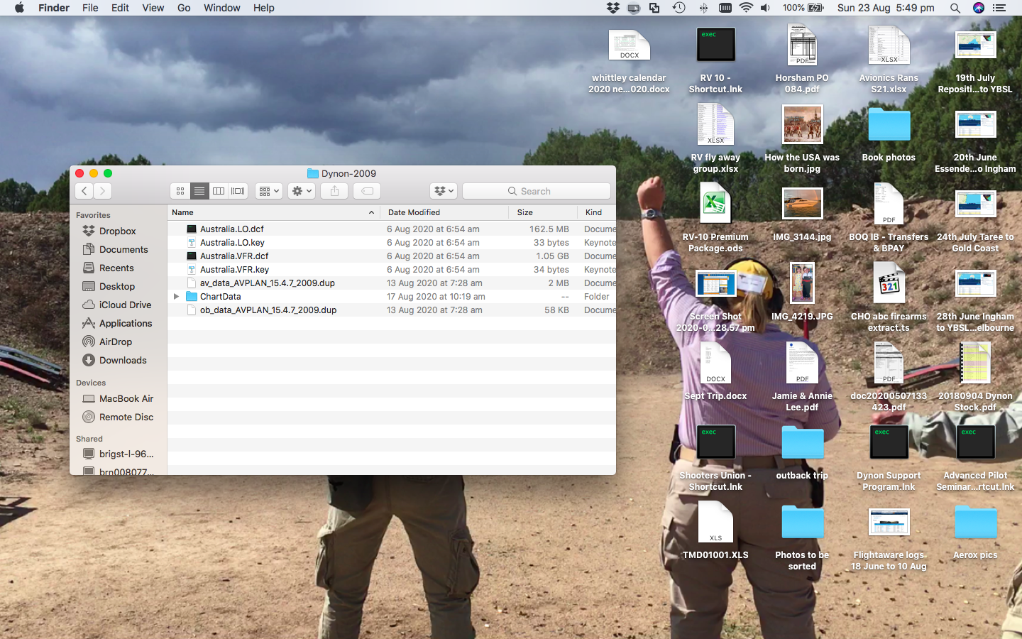

I am in the upside down land, and AvPlan here supply a similar chart service. The database uploads to the screen, however all the mapping and approach plates stay on the USB key.
The catch is they MUST appear in the root directory of the USB key, and not inside a folder. The charts are in a folder of their own, but thats OK, so here is what ours look like. (And yes my wife did beat the SWAT instructors son at Gunsite Academy for those who are curious about the background pic).
As you can see the original folder is the Dynon-2009 data release (year 20 and month 9) and the contents of that folder as shown below gets copied to the root directory of the USB key. The root directory is the first level when you open the USB stick up.
Hope this helps.
