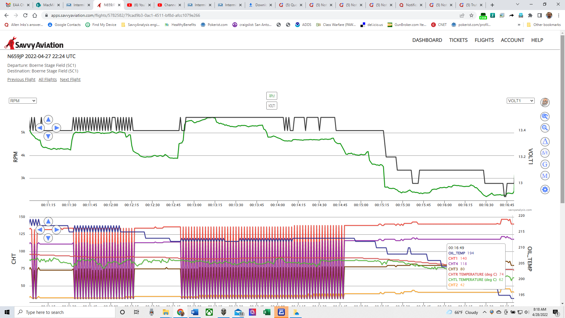

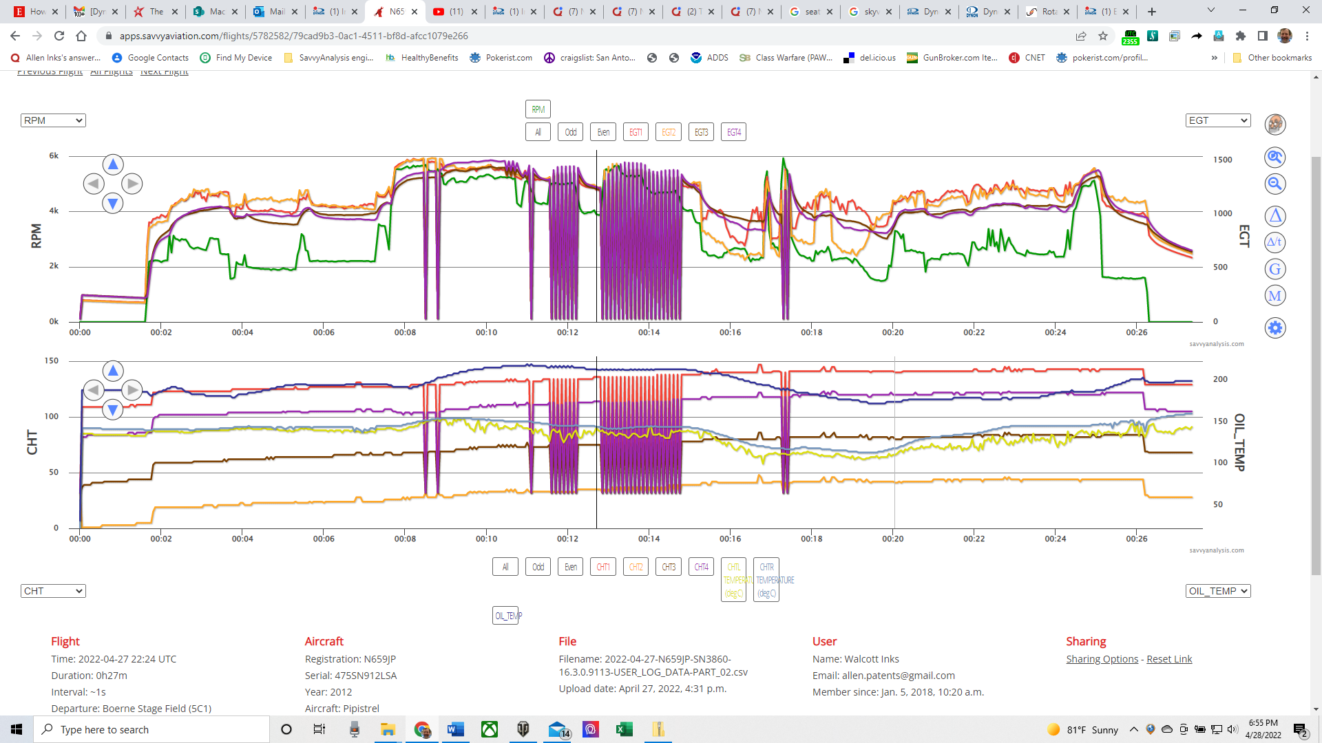

Looking at the user files, I see regular up and down spikes (sawtooth pattern) on just the following parameters
EGT
CHT
Coolant Temperatures
Oil Temperatures
Voltage....during one higher rpm part of the flight where I was seeing "sawtoothing" of the signals for the above parameters, but NOT continuously during the next higher rpm part of the flight here I was seeing sawtoothing of the signals for the above parameter. Wierd, hun?

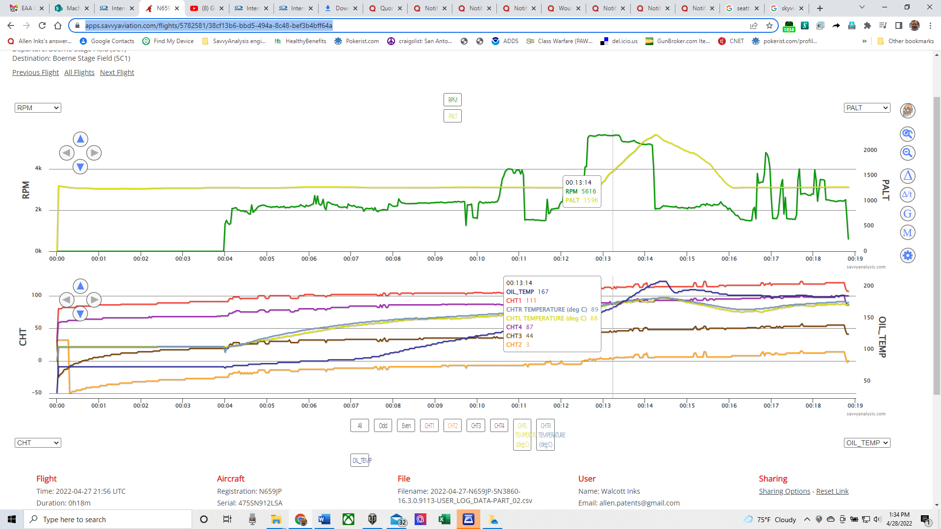

And here's the previous flight, just minutes earlier:
