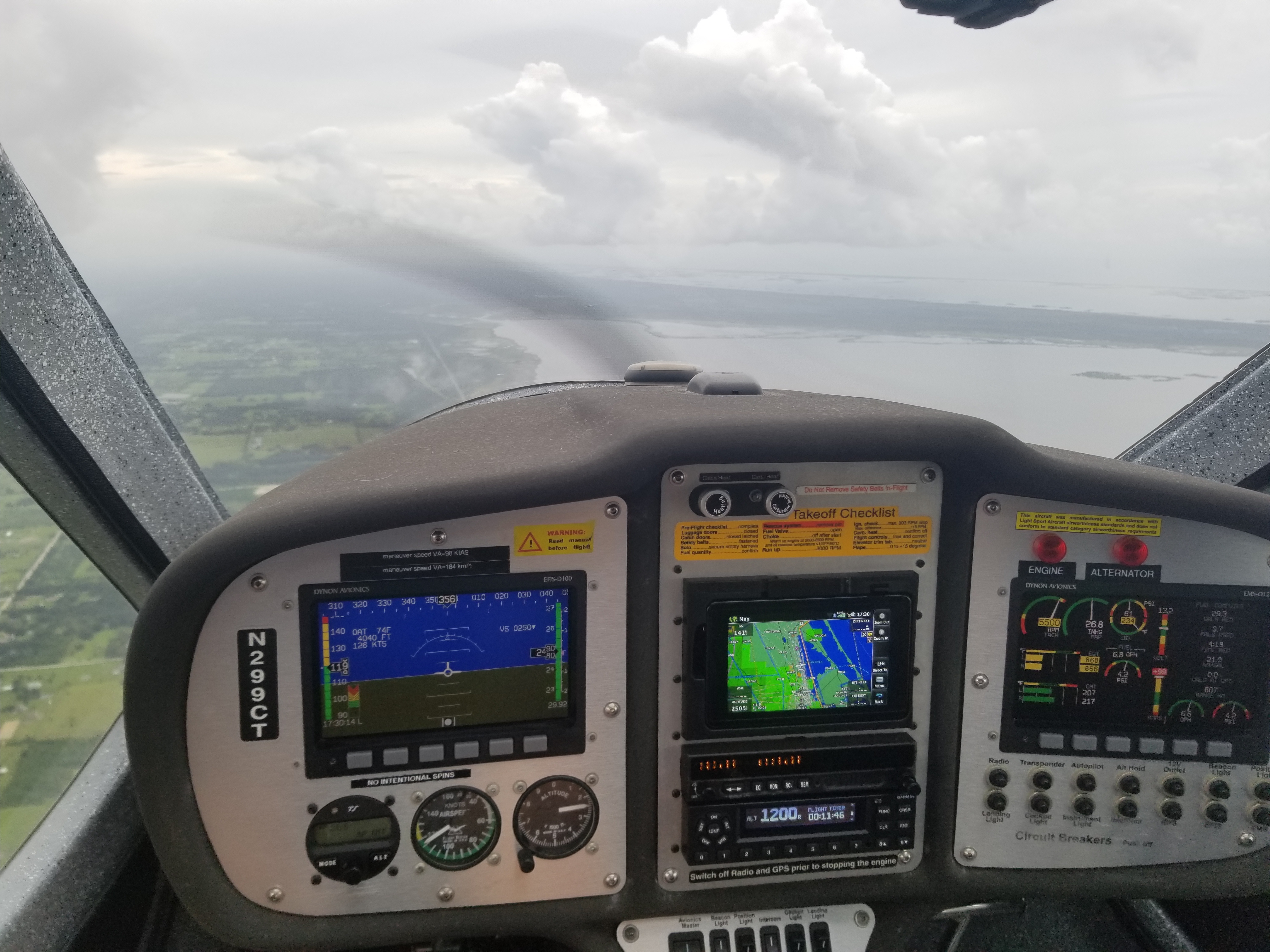

I have a D120 with low EGT readings. I am trying to determine if they are real.
This started a few months ago where the EGT readings started reading close in tandem and reading low. At times, they would go from 1150F to 1250F to 950F, all in the same flight, same altitude, same throttle setting. I have attached a photo showing the low readings. What you cannot see is the rapid temperature changes that appear to occur in tandem.

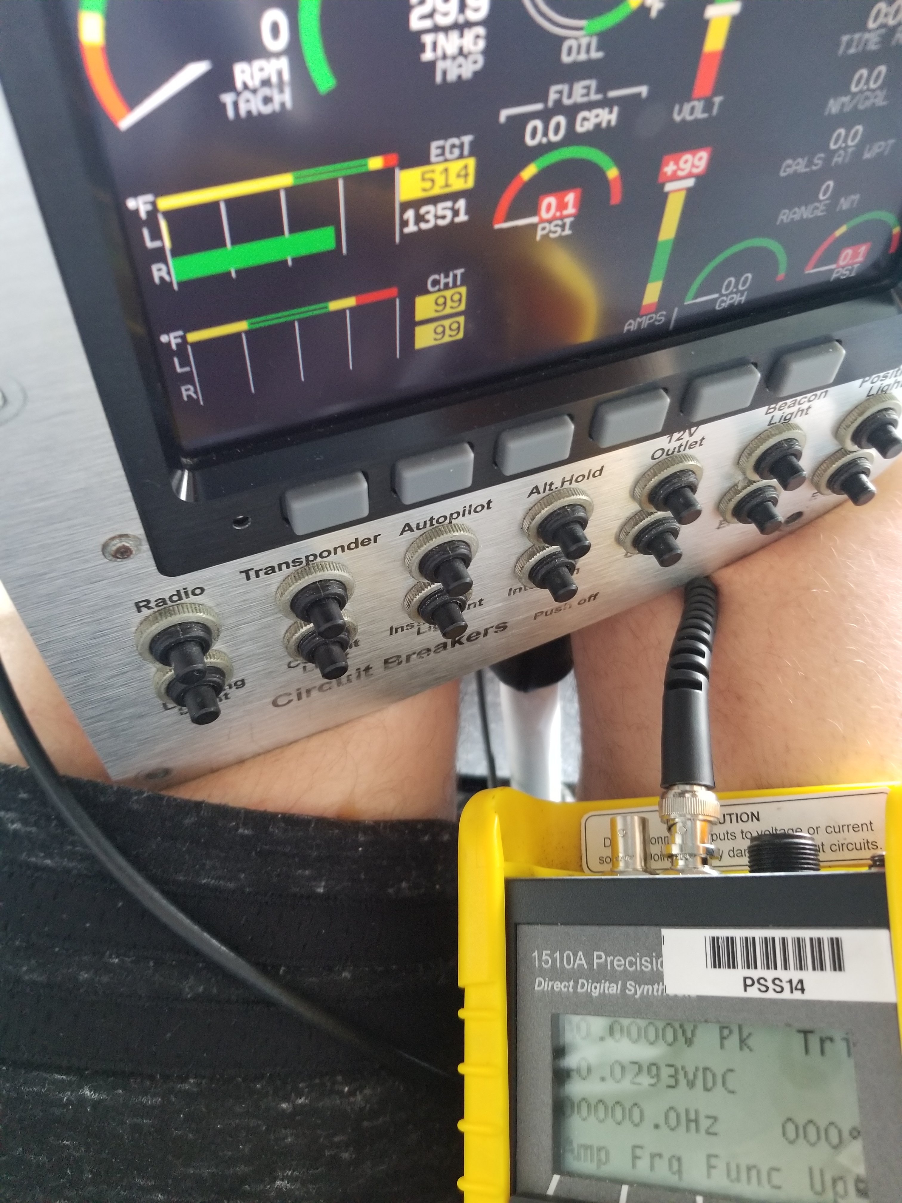

I shot a signal from Precision Signal source for 1300°F in type K on each channel at the multi-pin connector on the back of the dynon and I have attached the photos showing a 50°F higher reading. There is also a question of the mid-range temperature on the side not connected to anything.
Is this a cold junction issue or something you can repair if I send the unit?
