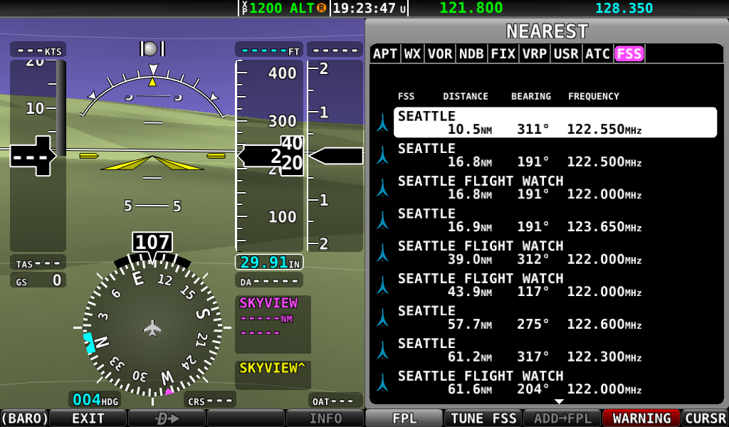

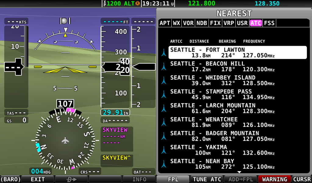

So it was some Tower and ATIS frequencies missing, which are items we already support. We can't just go and add new stuff without a software release But...
This database revision DOES add approach/departure frequencies to underlying airports. We could do this since we already supported approach and departure frequencies for some airports. So now if you look up KRNT for instance, it does now have a list of approach/departure frequencies. It has a nice narrative of what directions to use the frequency for as well.
This does not mean we have a list of center frequencies arbitrarily listed. The frequencies we have are the ones the FAA lists against specific airports. We will have the ability to look up ATC and FSS frequencies via the NEAREST function in the next software release.
A little preview, perhaps?
