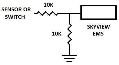

Great. Thanks, Don.Actually, I would put the pull down between the series resistor and EMS. It would probably still work the way you have it, but it isn't ideal.
So, this would be the proper configuration for a pull down resistor when an inline (series) resistor is installed. This is applicable to the enhanced type C general purpose inputs (pins 8, 22, 23, and 31) that do not have configurable internal pull ups.
