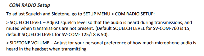

Just to check, have you adjusted the sidetone on the X25 COM?
It might be set at zero.
Sidetone is a product of the radio during transmit
I'll have to check that! I also borrowed a headset from a coworker to run a comparison. We'll see tomorrow morning...
update: yep, the sidetone value was set to 5. I reset it to 50 and it's much better. Had no idea that was a setting...
