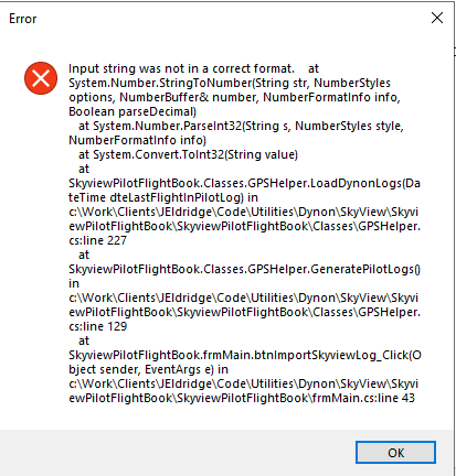

Tried this- it throws an immediate error. I noticed that it may expect the log file to end in .txt, mine end in .csv. I tried changing the test file to .txt, but still got the same error.
n363rv
Mar 25, 2021
10
Thanks HFMan... I sent you private message asking for your Dynon logs so I can take a look and see what is blowing up. Once I get the Dynon logs, I'll get if figured out and make it work. Thanks again for your feedback!!
Thank you. This has been fixed. The latest bug fixes have been applied to the zip file found in the first post of this thread.
