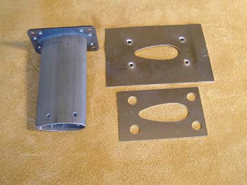

I am planning to buy the unheated AOA/Pitot Probe (#100141-000 ). It requires a mounting bracket. I noticed on the Dynon website that they offer Builder Support Products. There is a Pitot Mount Bracket for the VANS aircraft. Would this bracket work for the RANS S-19 Venterra? Is the installation pretty straightforward? Why might it be restricted to the VANS aircraft? Thanks, Mike.

The parts to mount this in the Venterra are described in the Wing Assembly parts manual.

Before you go ahead with this I have a question - what is the thickness of the wing skin & inspection plate in the area you may want to install the pitot tube ?
