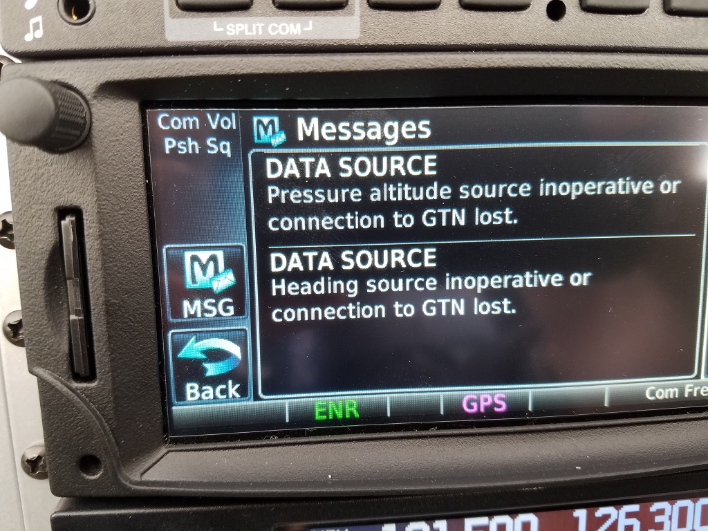

On taxi out, after everything has had sufficient time to acquire GPS satellites and settle into the groove of being powered on, the GTN spits out the message shown in the attached picture.

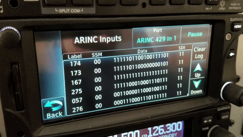

So, here is what the ARINC test screen looks like--I couldn't find an "input data test page"; could you be more specific about what you'd like to see?
Additionally, none of the RS-232 input screens (on the GTN) showed any activity. I assume this is normal--my understanding is heading/air data is transmitted via ARINC.

Here are the labels I see from your GIF:
057 : SPARE
166 : North/South Velocity
167 : Position Estimate Uncertanty
173 : Localizer Deviation
174 : East/West Velocity
230 : Left outer probes capacitance
275 : MISC
276 : MISC
277 : Fuel transfer and CG status
In other words, none of your labels make any sense for any device in a plane. Almost looks like repetitive noise.

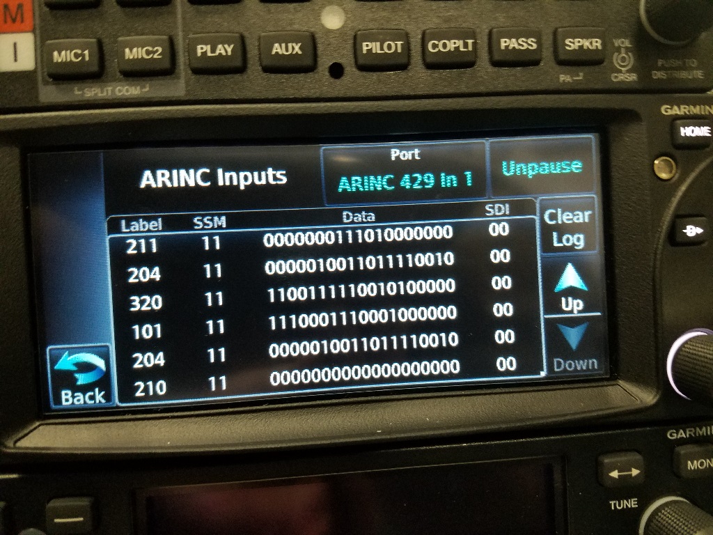

Thank you for solving this one. Picture attached of gloriously appropriate ARINC labels!
