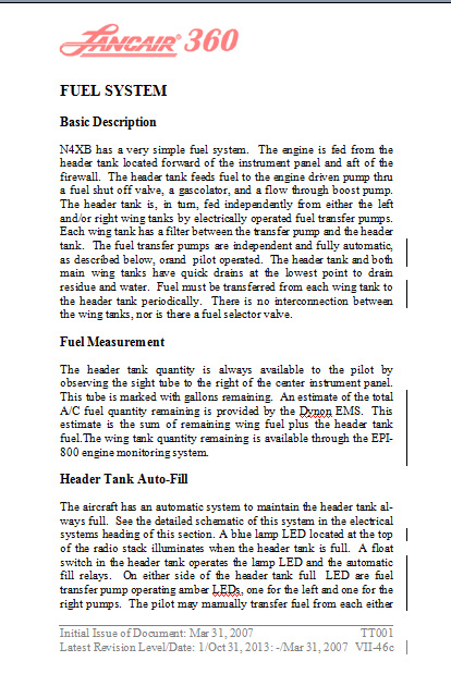

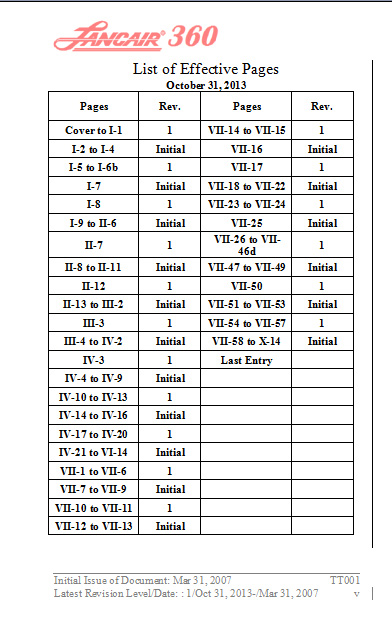

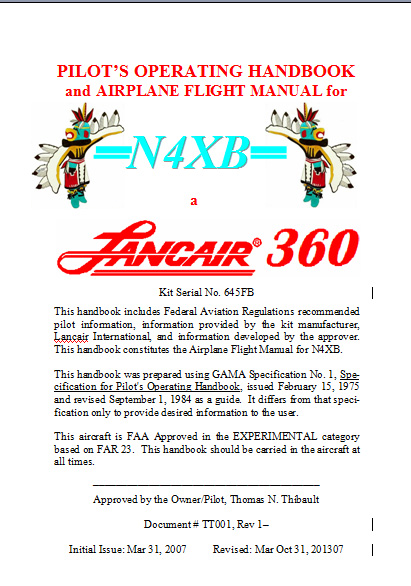

Before Skyview came along, I wanted to make the POH for my Lancair reflect my as-built airplane, so I created a Word document from the factory template and maintain it using the same method as the Air Force manuals.
The end product looks like the attached sample pages. There is a revision log, a list of affected pages, and every page that has changes on it has a vertical bar beside every change.
Again, the effort is mostly done using "track changes" within MS Word.
