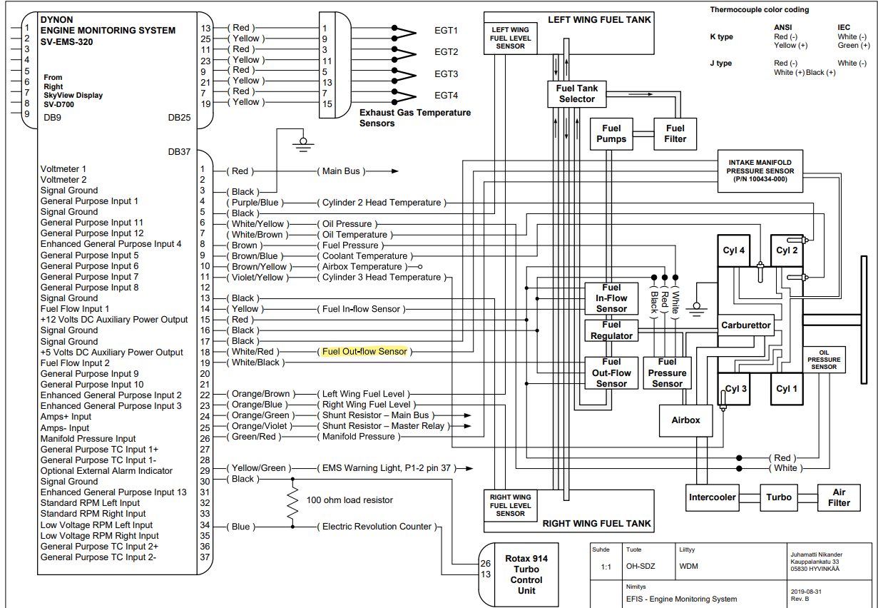

I have SkyView system with EMS-220 connected to Rotax 914 motor.
Two topics:
1) Rotax 914 + two FT-60 fuel flow sensors.
I am measuring motor fuel flow using two FT-60 fuel flow sensors as instructed in the SkyView System Installation Guide - Revision AB, page 7-59.
The inflow FT-60 is connected to pin 14 (yellow) and outflow FT-60 to pin 19 (white/black).
However, when motor is running and fuel flowing, the fuel flow reading is showing very high consumption as if SkyView was not measuring the differential fuel flow based on both sensors. I have measured that both sensors are giving the amount of pulses with oscilloscope, and calibration has been set to 68000 pulses.
SkyView software version is 14.2.1.3698.
2) Rotax 914 engine rpm measurement
There is a mistake in the SkyView System Installation Guide - Revision AB, page 7-48 saying:
"Do not install a resistor in the wires between the TCU and the SV-EMS-220".
First of all, Rotax 914 rpm information comes from Rotax 914 TCU pins 13 (rpm) and 26 (gnd).
Rotax 914 TCU pin 13 must be connected to EMS-220 pin 34 (Low voltage rpm input left), and Rotax 914 TCU pin 26 to ground.
Then, there has to be a 100 ohm load resistor connected between EMS-220 pin 34 and ground.
The 100 ohm load resistor is mentioned in Rotax 914 Installation Manual Edition 2 / Rev. 0, July 01/2008 page 125. However, this information has been omitted in new revisions.
RPM readings were erratic and not working at all without the 100 ohm load resistor even if RPM reading was connected to EMS-220 Standard RPM input.
I used oscilloscope to measure the real signal from Rotax 914TCU. The measured RPM signal from Rotax 914 TCU was 50 V impulses (2500 rpm) and it reduced to 8 volts with the load resistor.

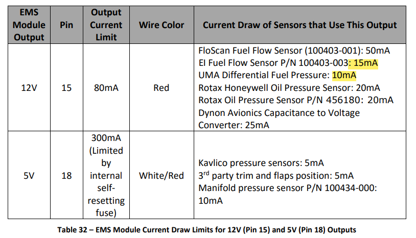

The issue suggested in my last comment just realized last summer during cross country flight. Fuel flow reading started to increase steadily from 15 LTR/HOUR until value maxed out to something likes >60 LTR/HOUR. Engine was still running perfectly fine and no smell of gasoline. Landing was also normal. I believe the return flow sensor gradually stopped working, maybe too much load in 5V supply. I have not yet had time to investigate real root cause.
If there would be possibility to show fuel flow from both sensors separately AND difference, it would have been good indication that at least fuel is flowing. Luckily I didn't had to declare emergency in flight.
I work in elevator industry. In old machines there was two speed measurements and their difference was measured. If one sensor breaks, then difference increases and elevator is stopped. However, if power supply to both sensors die, then difference was still zero, which means speed difference supervision could not stop elevator. Without speed sensors, control loop is open. If actual speed was also near zero during failure, then elevator would not have been stopped by speed error supervision. Luckily, new systems have improved speed and position sensors supervisions.
Recommendation: Add option to show fuel flow reading from both sensors, not just difference.
2,154
I know I'm late to the party & I could be wrong -
Isn't the power to the fuel flow cube a regulated 12V- not 5 volt? I've never measured it.
