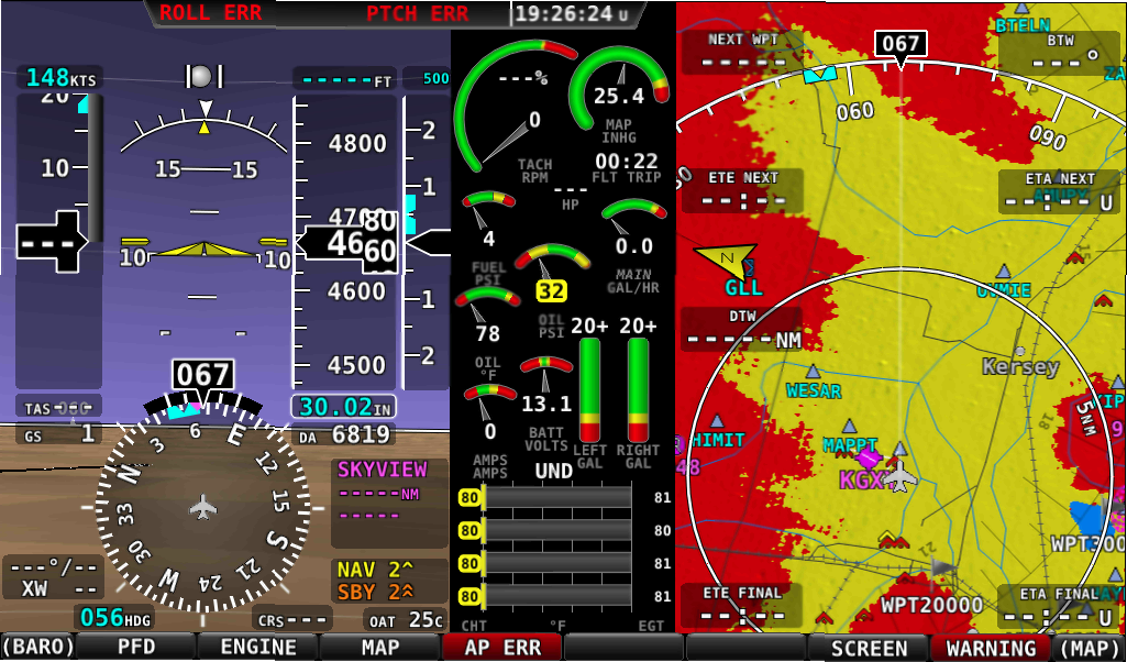

Put the Dynon stick in and when you see a screen  you want to shoot, hold down 2 and 7 at the same time.  Presto, you got a shot!
Here is an example:
[IMG]http://i41.tinypic.com/dzwbaw.jpg[/IMG]

Thanks all for the info on screen shots.  I tried it and in order to open the BMP on a MAC I had to convert it to an HTML format using Safari  and then had to save it as a PNG Color file.  The JPG saves were too small and when enlarged were unreadable Here is what it looks like: :)
