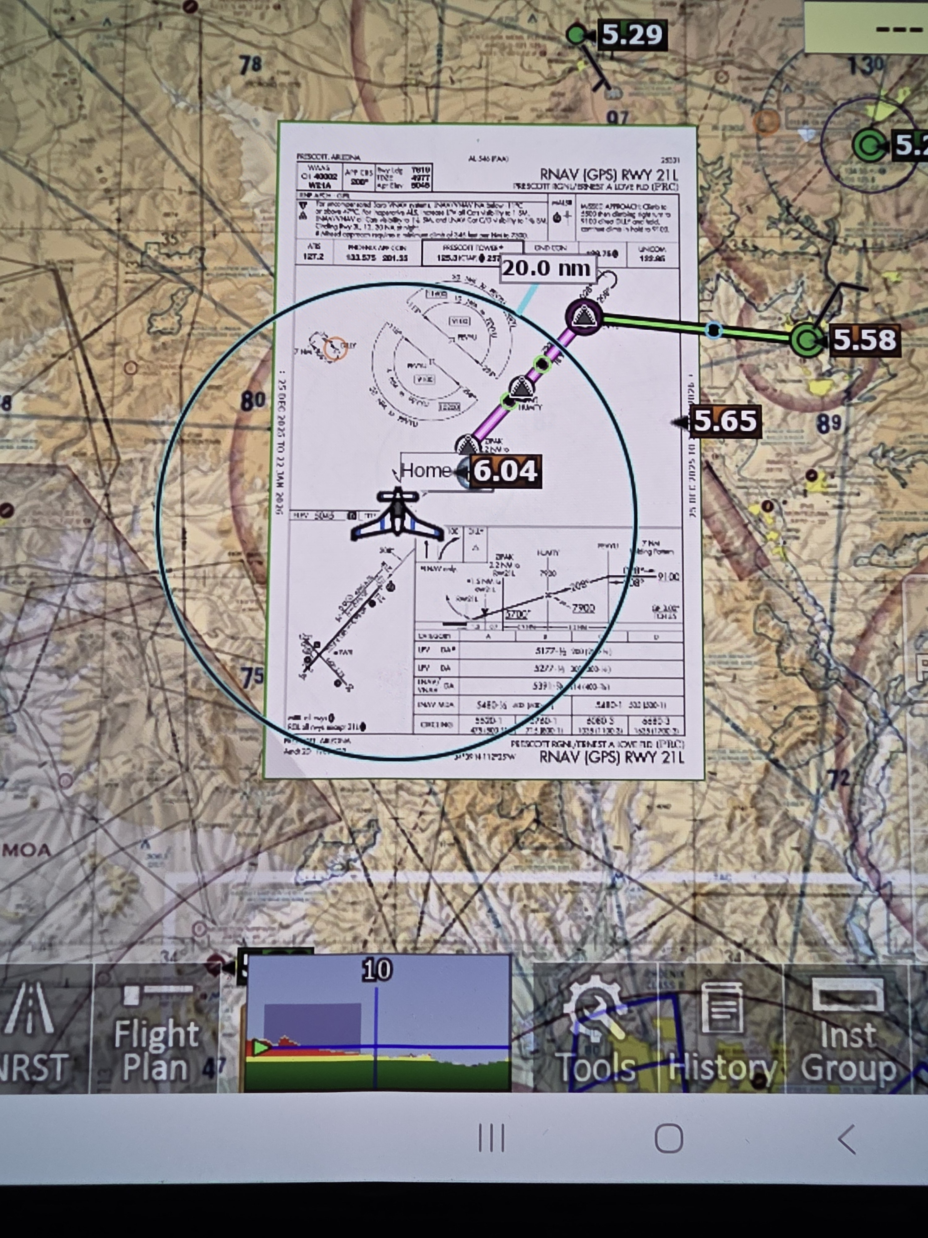

Yes, I know about Seattle Avionics. Have a subscription and use that feature often. But I have not found a way to display an approach plate on the moving map. Granted, it does display a geo-referenced aircraft icon, but it is not a fully featured moving map. (With the other layers on the current configured moving map displayed above, below and to the side of the plate as shown below). What I am asking about is what is displayed, for example, in iFlyEFB when you call up an approach plate. Outside the plate boundaries, this display should show all the data elements that are on the standard moving map. Optimally, overlaid on the plate, (within the plate borders), it could displsy ADS-B traffic, and maybe NEXTRAD weather....
Is there a way to get the same, (or similar), display on the moving map in Skyview? On either HDX or Touch?

This does NOT display the approach plate as an overlay on the moving map, as Foreflight does - it merely displays the geolocated approach plate in the moving map part of the display. Charly is aware of THIS functionality, but he (and others) are looking for more - the ability to see the plate overlaid on the moving map. Dynon does NOT have this functionality.
In my COZY MKIV, with two screens, I keep the moving map displayed on the right screen and the approach plate on the left, so I have SA from both, but it would be nice to have it all on one screen, and in a Berkut, such as Charly's, where there's only room for one screen, you can't have both moving map and approach plate. For those folks, it would be necessary to have the moving map on Foreflight on a separate device.
Similarly, while the airport diagram is geolocated, it is NOT displayed on top of the moving map (and due to the scale, there's no reason for wanting THAT).

Yes, this is as I suspected. I posted this on the slight chance that there was a menu setting or a setup configuration option, that I was unaware of, that might implement this functionality. In my Berkut, there is no room for a second screen, so I can't use the technique Air Guy suggests. I have to have one half of the screen dedicated as a PFD, so on the other half I have to choose between the plate by itself, or a moving map with just the flight plan. I end up displaying the PFD and Plate on my HDX screen, and the plate overlaid on a moving map on my stand-alone Android device, in iFlyEFB (as shown above).
It would be a welcome addition to the Skyview system, as it is a glaring omission to display the plate, (even though it is georeferenced), without all the other functionality available on the moving map. As you suggested, If implemented, a toggle, or config setting, to control clutter that would interfere with critical approach plate data would be important.
