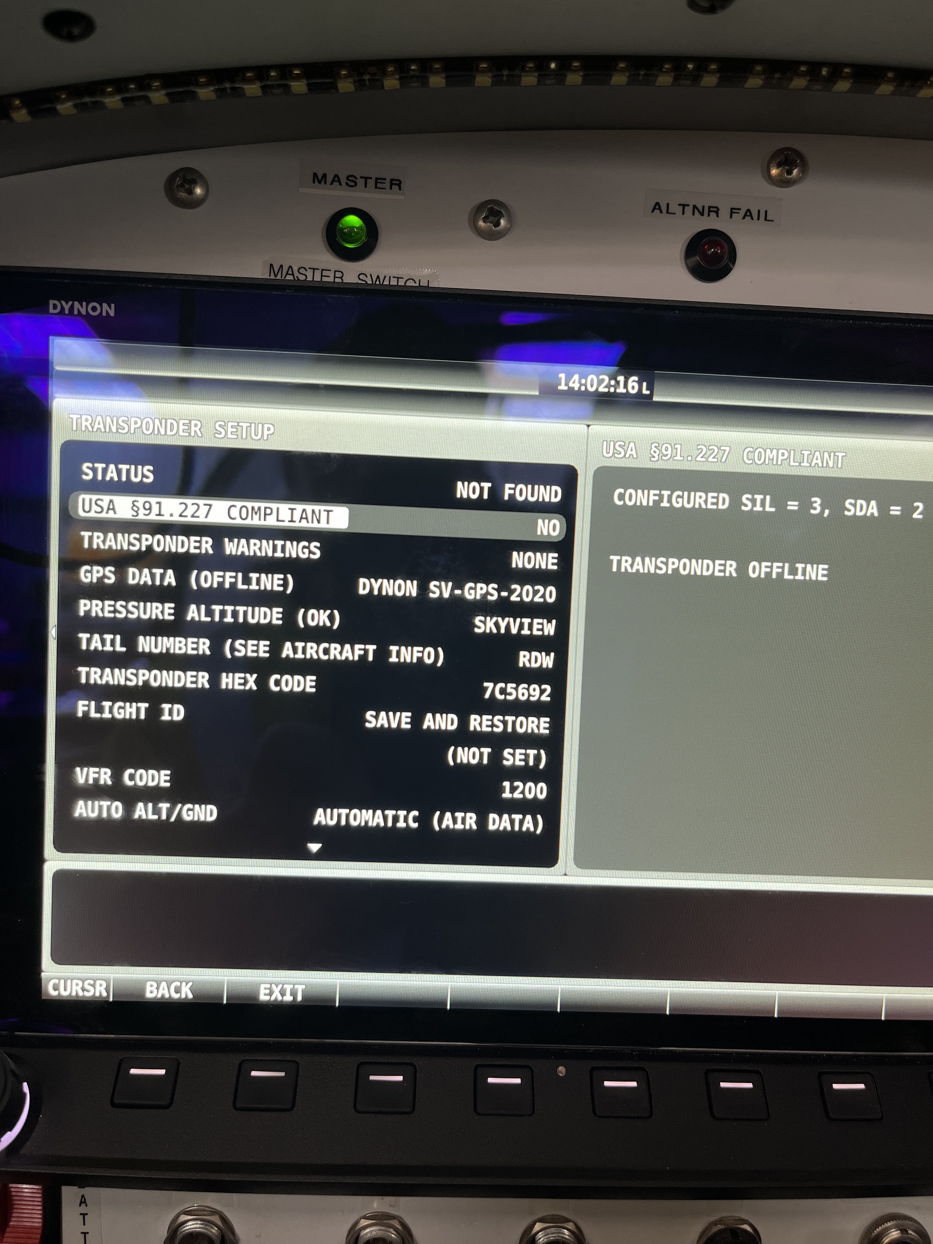

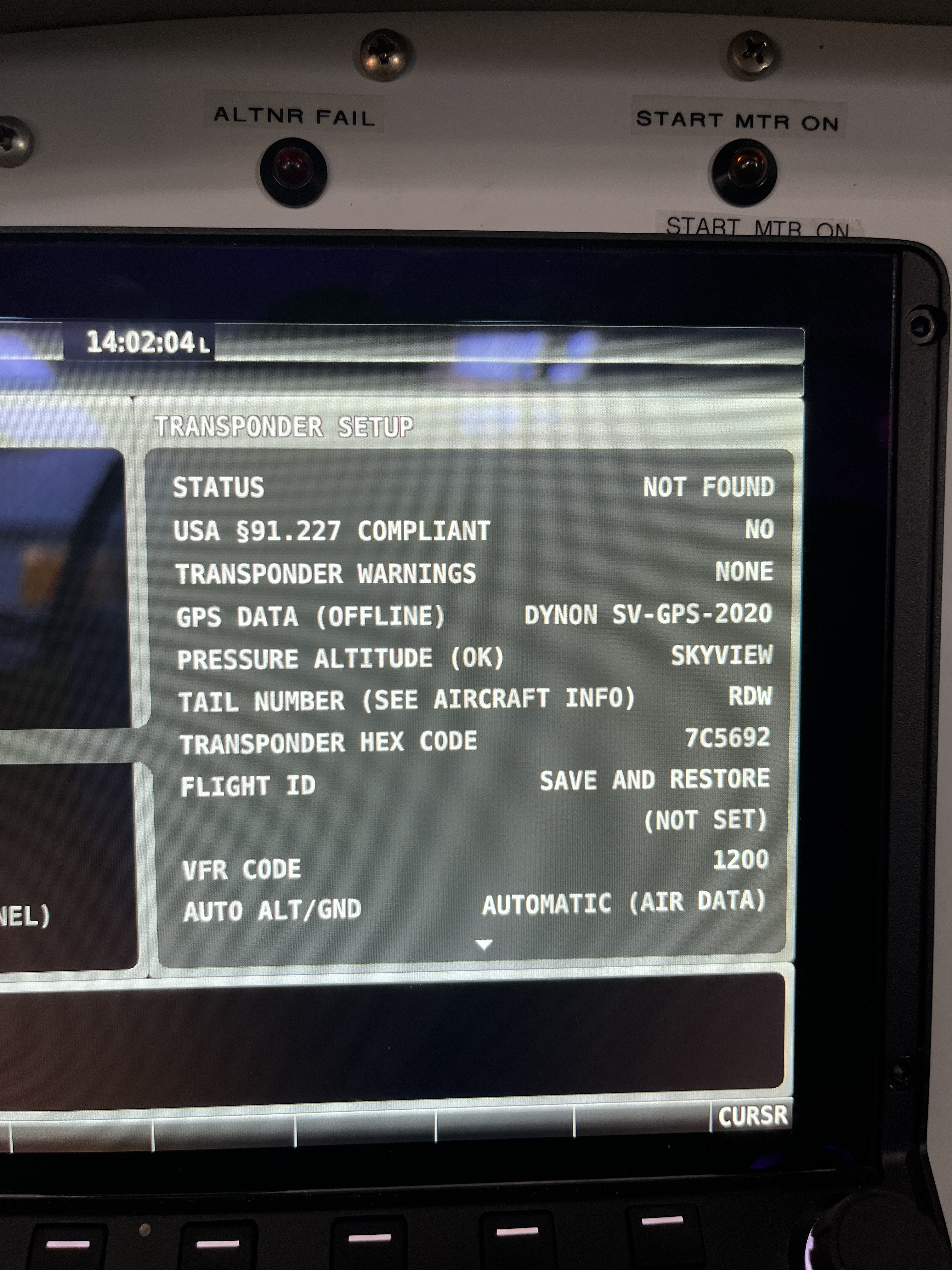

No success with my newish HDX. I waited 10 mis after it hung up at 99% complete. Pressed buttons 1,2 and 5 all together , rebooted and no Txp indications on top of screen. When went to Transponder setup said STATUS Not found, Transponder offline. See attach below. I tried the 1,2 ,5 reset twice, same finding suggesting my Txp not working. Can anyone help with a fix ? JeffR
Hi Jeff,
If you haven't already, please email us at support@dynon.com. You can put attn: David and it will get to me directly.

Well,after returning to plane and applying power to HDX, the next day,it appears that the Txp did load up after all and the Txp Ver 2.15 was installed. The Txp functioned as previously with ADSB out etc functioning to allow other aircraft to see me as well as ATC .I don't know why the hiccough!!!!
